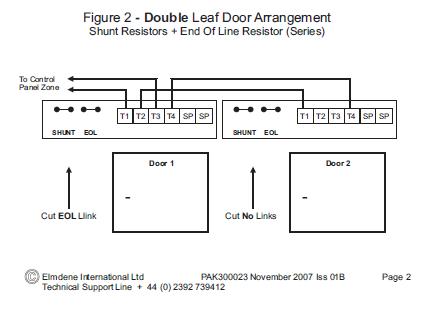

johno63 Posted September 28, 2010 Share Posted September 28, 2010 got to upgrade system to galaxy g3 and use exsisting wiring, but it has got 4 contacts on one zone, these are being replaced for elmdene g3 contacts can you wire all 4 to one zone if so how please Link to comment https://www.thesecurityinstaller.co.uk/community/topic/29820-g3-contacts/ Share on other sites More sharing options...
arfur mo Posted September 28, 2010 Share Posted September 28, 2010 To add more than one contact you use only one end of Line resistor at the furthest point, so the last device has two resistors. Imagine wiring the eol resistor as the 5th contact. I.e all reeds I'n series with the resistor. Now fit 'bridging' resistors across each reed. Not used G3 contacts, if they have a separate connection to detect substitution then follow the panels manual is best. Intersting question, as far as I know the limit is what the panel supports as maximum contacts per zone. Personal preference is all contacts on dedicated zones, far easier to nail down any future false alarms or CNS, remember this is for the life of the system, so especially so for G3 substation errors, for what is a little added effort now. Arfur If you think education is difficult, try being stupid!!!! Link to comment https://www.thesecurityinstaller.co.uk/community/topic/29820-g3-contacts/#findComment-252903 Share on other sites More sharing options...

james.wilson Posted September 28, 2010 Share Posted September 28, 2010 not easy with built in resistors, but easier on the gal than others. See attached and just extend the theory. securitywarehouse Security Supplies from Security Warehouse Trade Members please contact us for your TSI vetted trade discount. Link to comment https://www.thesecurityinstaller.co.uk/community/topic/29820-g3-contacts/#findComment-252909 Share on other sites More sharing options...

james.wilson Posted September 28, 2010 Share Posted September 28, 2010 Possibly but possibly not on built in resistors. WE don't do it so our engineers possibly wouldn't know of the top of their heads securitywarehouse Security Supplies from Security Warehouse Trade Members please contact us for your TSI vetted trade discount. Link to comment https://www.thesecurityinstaller.co.uk/community/topic/29820-g3-contacts/#findComment-252930 Share on other sites More sharing options...
arfur mo Posted September 28, 2010 Share Posted September 28, 2010 not easy with built in resistors, but easier on the gal than others. See attached and just extend the theory. So is there no dedicated 'substitution' indication as I'n trouble with pirs James ? Seems dam daft if not IMHO Is there any restriction under G3? Arfur If you think education is difficult, try being stupid!!!! Link to comment https://www.thesecurityinstaller.co.uk/community/topic/29820-g3-contacts/#findComment-252931 Share on other sites More sharing options...
james.wilson Posted September 28, 2010 Share Posted September 28, 2010 So is there no dedicated 'substitution' indication as I'n trouble with pirs James ? they are immune arf. you can either detect or use immune contacts. i personally think detection and tampers are a bad idea. yes there is a restriction on G3 securitywarehouse Security Supplies from Security Warehouse Trade Members please contact us for your TSI vetted trade discount. Link to comment https://www.thesecurityinstaller.co.uk/community/topic/29820-g3-contacts/#findComment-252935 Share on other sites More sharing options...
