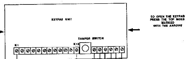

magpye Posted May 29, 2009 Share Posted May 29, 2009 Thanks to Redbull and Lawandorder for your quick responses.I've had a look in the sound box to check for a reset button but the only thing that seems to fit the bill is a small white button. When pressed this sets off the alarm but when that's turned off with the override code the tamper light stays on. The reset button needs to be reset, but I can't see how to do it for it doesn't seem to match up with a pressure point and there is no spring. Sorry, still stumped! This should help, a drawing of a, cover removed, Concept KeyPad Someone told me I was ignorant and apathetic, I don't know what that means, nor do I care. Link to comment https://www.thesecurityinstaller.co.uk/community/topic/28877-concept-keypad-problem/#findComment-238872 Share on other sites More sharing options...
