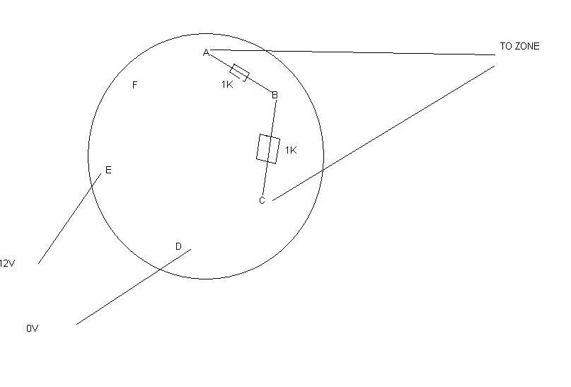

timmo Posted May 15, 2009 Share Posted May 15, 2009 Hello all, just a query regarding my new galaxy g2-20 panel... i have got a texecom smoke detector to attach to the system but i'm not sure how to go on with the resistors/wiring, as the detector doesn't have tamper connections - it only has the usual 12v and 0v plus two alarm/comm contacts. How would i wire resistors into it in order for the panel to recognise it??? Oh, also, any suggestions for some sort of auto-dialler for the G2-20? I really want something that uses gprs/gsm as my hardwired bt line isn't exactly secure. The wife won't have monitored (yet anyhow - I'm working on it, would love to have it!) so what would my options be in this situation? The system was put in by myself (to a good standard) so it's not under a company/engineer/service contract... ALL SUGGESTIONS GREATLY APPRECIATED, THANKS. Link to comment https://www.thesecurityinstaller.co.uk/community/topic/28689-galaxy-g2-20-peripherals/ Share on other sites More sharing options...
Guest old-hand Posted May 15, 2009 Share Posted May 15, 2009 Hello all, just a query regarding my new galaxy g2-20 panel... i have got a texecom smoke detector to attach to the system but i'm not sure how to go on with the resistors/wiring, as the detector doesn't have tamper connections - it only has the usual 12v and 0v plus two alarm/comm contacts. How would i wire resistors into it in order for the panel to recognise it???Oh, also, any suggestions for some sort of auto-dialler for the G2-20? I really want something that uses gprs/gsm as my hardwired bt line isn't exactly secure. The wife won't have monitored (yet anyhow - I'm working on it, would love to have it!) so what would my options be in this situation? The system was put in by myself (to a good standard) so it's not under a company/engineer/service contract... ALL SUGGESTIONS GREATLY APPRECIATED, THANKS. Wire the smoke EOL as per other devices using a piece of connector strip to make final connection. The manual supplied will show this method. Why use a auto dialler, oh yes you mention a insecure phone line............G2-20 does have sms facility, of course you know this. GD-06-SMS module might help, with PSYG Sim card. Search the site sponsor`s for prices. You suggest the system is fitted to a "good" standard. How would you define that? Without going into too much detail, please define a "good" standard. As a "professional" I and my fellow "professionals" would love to have an understanding of someone who fits an item to no regulation. Then says it is a good installation. ? I`ll leave you to answer, before I comment any further. Link to comment https://www.thesecurityinstaller.co.uk/community/topic/28689-galaxy-g2-20-peripherals/#findComment-237382 Share on other sites More sharing options...

breff Posted May 17, 2009 Share Posted May 17, 2009 Hello all, just a query regarding my new galaxy g2-20 panel... i have got a texecom smoke detector to attach to the system but i'm not sure how to go on with the resistors/wiring, as the detector doesn't have tamper connections - it only has the usual 12v and 0v plus two alarm/comm contacts. How would i wire resistors into it in order for the panel to recognise it???Oh, also, any suggestions for some sort of auto-dialler for the G2-20? I really want something that uses gprs/gsm as my hardwired bt line isn't exactly secure. The wife won't have monitored (yet anyhow - I'm working on it, would love to have it!) so what would my options be in this situation? The system was put in by myself (to a good standard) so it's not under a company/engineer/service contract... ALL SUGGESTIONS GREATLY APPRECIATED, THANKS. Wire as this drawing The opinions I express are mine and are usually correct! (Except when I'm wrong)(which I'm not) Link to comment https://www.thesecurityinstaller.co.uk/community/topic/28689-galaxy-g2-20-peripherals/#findComment-237461 Share on other sites More sharing options...

timmo Posted May 17, 2009 Author Share Posted May 17, 2009 Wire as this drawing Thanks for your help, much appreciated! Link to comment https://www.thesecurityinstaller.co.uk/community/topic/28689-galaxy-g2-20-peripherals/#findComment-237529 Share on other sites More sharing options...
