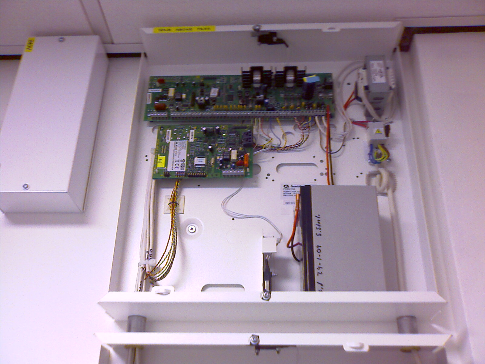

whistle Posted April 19, 2009 Share Posted April 19, 2009 Tape them up and leave about 8" long. Link to comment https://www.thesecurityinstaller.co.uk/community/topic/28240-to-screen-or-not-to-screen/page/2/#findComment-234085 Share on other sites More sharing options...
antinode Posted April 19, 2009 Share Posted April 19, 2009 Tape them up and leave about 8" long. Not a bad effort Trade Member Link to comment https://www.thesecurityinstaller.co.uk/community/topic/28240-to-screen-or-not-to-screen/page/2/#findComment-234088 Share on other sites More sharing options...
james.wilson Posted April 19, 2009 Share Posted April 19, 2009 they do look pretty lads ps what is the lower one, scanny smart psu? securitywarehouse Security Supplies from Security Warehouse Trade Members please contact us for your TSI vetted trade discount. Link to comment https://www.thesecurityinstaller.co.uk/community/topic/28240-to-screen-or-not-to-screen/page/2/#findComment-234090 Share on other sites More sharing options...
antinode Posted April 19, 2009 Share Posted April 19, 2009 It's a Guardall PX Smart Concentrator. Here's the panel (PX80i) Trade Member Link to comment https://www.thesecurityinstaller.co.uk/community/topic/28240-to-screen-or-not-to-screen/page/2/#findComment-234092 Share on other sites More sharing options...

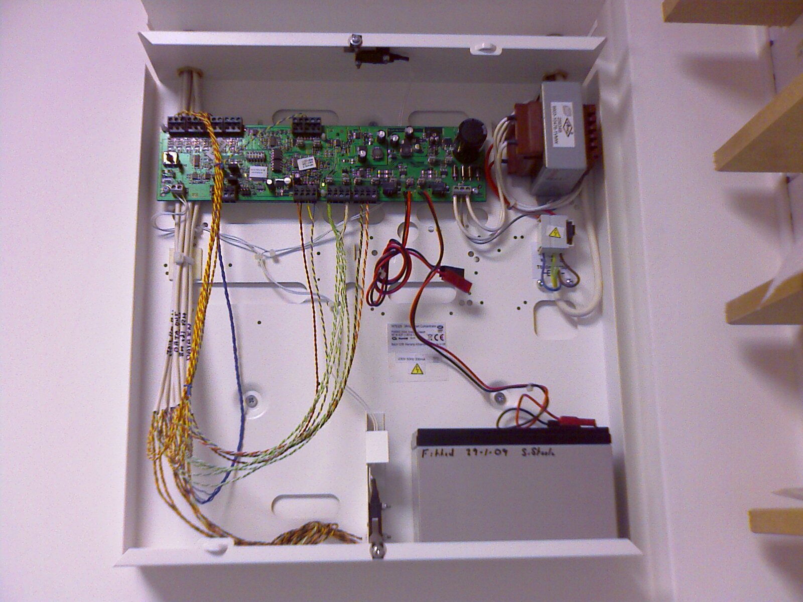

james.wilson Posted April 19, 2009 Share Posted April 19, 2009 ot but i liked the way you could fit 2 x 7A.h securitywarehouse Security Supplies from Security Warehouse Trade Members please contact us for your TSI vetted trade discount. Link to comment https://www.thesecurityinstaller.co.uk/community/topic/28240-to-screen-or-not-to-screen/page/2/#findComment-234093 Share on other sites More sharing options...
antinode Posted April 19, 2009 Share Posted April 19, 2009 Those smart PSU's will charge 2 x 17ah if you needed them. They weigh a ton aswell. Not bad panels IMO. Trade Member Link to comment https://www.thesecurityinstaller.co.uk/community/topic/28240-to-screen-or-not-to-screen/page/2/#findComment-234095 Share on other sites More sharing options...
Chorlton Posted April 19, 2009 Share Posted April 19, 2009 look whistle antinode managed to date the batteries too marker pen OK for that though? I've been using dyno tape since being told otherwise on here by someone. Link to comment https://www.thesecurityinstaller.co.uk/community/topic/28240-to-screen-or-not-to-screen/page/2/#findComment-234096 Share on other sites More sharing options...
james.wilson Posted April 19, 2009 Share Posted April 19, 2009 marker pen is fine AFAIK. You have to date the batteries when they come into stock and when fitted (for rotation etc) but that may be a nacoss req and not needed for ssaib securitywarehouse Security Supplies from Security Warehouse Trade Members please contact us for your TSI vetted trade discount. Link to comment https://www.thesecurityinstaller.co.uk/community/topic/28240-to-screen-or-not-to-screen/page/2/#findComment-234097 Share on other sites More sharing options...
Chorlton Posted April 19, 2009 Share Posted April 19, 2009 no worries I remember a topic about this from year ago or so and someone produced details from Yuasa or powersonic etc saying marker pen was not OK but don't have 1st hand knowledge, hence question. I bought 2 dyno machines and it looks better and comes in handy for labelling devices and other stuff too Don't date when come into stock though just rotate and (since very recently) recharge after 3 months if still on the shelf. Link to comment https://www.thesecurityinstaller.co.uk/community/topic/28240-to-screen-or-not-to-screen/page/2/#findComment-234098 Share on other sites More sharing options...
