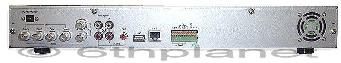

madkad Posted December 10, 2008 Author Share Posted December 10, 2008 you can but those outputs are not the same. I dont know that dvr (i assume its a bottom end one?) but usually you have a main monitor and a spot monitor.These outputs are different and do different jobs. They are not duplicates of the same signal. You may need a video distribution amplifier thanks mate the back looks like this one, it doesnt say any different on the outputs I think I will try and do a little test on them before trying it out in full. I dont know if its the bottom end one, any way of finding out? here are some specs: Format: PAL / CCIR HDD: 250GB + blank Compression: MJPEG Record Mode: Continuous / Alarm / Timer Motion Record Speeds: 100, 50, 25, 12, 8, 4 or 1fps Playback Speeds: 1/16x to Real Time to 32x Search Modes: Search by Time, Date, Alarm, Motion On screen display: Time, Date, Camera Titles Security: Password Protection/Key Lock Camera Inputs : 4 BNC Sockets (Video) Video Spec CCIR Composite, 1.0V p-p / 75Ω Monitor Output: 2 BNC Sockets Monitor Spec CCIR Composite, 1.0V p-p / 75Ω Audio Inputs 4 x RCA (Phono) Connectors, Selectable by camera. Audio Spec -8Db, 22KΩ Audio Output 1 x RCA (Phono) Connectors Audio Spec -8Db, 22KΩ Display Resolution: 720x576 in Real Time Recording Resolution: 720 x 288 @ 50fps 360 x 288 @ 100fps Alarm Inputs: 4 sets to activate recording (NO / NC) Alarm Output: 1 set relay contact Power Source: 240V AC input Power Supply (supplied) Operating Temperature: -10 Link to comment https://www.thesecurityinstaller.co.uk/community/topic/25906-dvr-to-2-tv-sets/#findComment-218413 Share on other sites More sharing options...
james.wilson Posted December 10, 2008 Share Posted December 10, 2008 looking at that it would appear it dont have a spot monitor output. I would also assume that they are just duplicates of each other. You will need to test it to see. securitywarehouse Security Supplies from Security Warehouse Trade Members please contact us for your TSI vetted trade discount. Link to comment https://www.thesecurityinstaller.co.uk/community/topic/25906-dvr-to-2-tv-sets/#findComment-218414 Share on other sites More sharing options...
