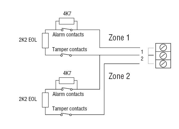

alarmman62 Posted October 24, 2008 Share Posted October 24, 2008 i am new to this and was wondering if anyone could give me the correct wiring details for eol resistors and what pirs are best suited thanks Link to comment https://www.thesecurityinstaller.co.uk/community/topic/25246-scantronic/ Share on other sites More sharing options...
james.wilson Posted October 24, 2008 Share Posted October 24, 2008 scanny use 4k7 and 2k2 i think so you need the 4k7 accross your alarm relay and the 2k2 in series. Best pir IMO is either optex or honeywell securitywarehouse Security Supplies from Security Warehouse Trade Members please contact us for your TSI vetted trade discount. Link to comment https://www.thesecurityinstaller.co.uk/community/topic/25246-scantronic/#findComment-214338 Share on other sites More sharing options...
alarmman62 Posted October 24, 2008 Author Share Posted October 24, 2008 scanny use 4k7 and 2k2 i thinkso you need the 4k7 accross your alarm relay and the 2k2 in series. Best pir IMO is either optex or honeywell do you have a diagram please Link to comment https://www.thesecurityinstaller.co.uk/community/topic/25246-scantronic/#findComment-214342 Share on other sites More sharing options...
james.wilson Posted October 24, 2008 Share Posted October 24, 2008 do you have a diagram please Its in the manual but see attached securitywarehouse Security Supplies from Security Warehouse Trade Members please contact us for your TSI vetted trade discount. Link to comment https://www.thesecurityinstaller.co.uk/community/topic/25246-scantronic/#findComment-214344 Share on other sites More sharing options...
