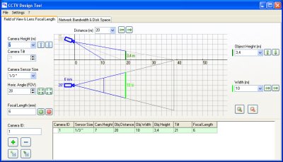

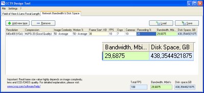

ieye Posted October 7, 2008 Share Posted October 7, 2008 IMHO it is not hard to install cctv system with 10 ip cameras. I have installed such systems myself. It doesn't take too much time. For faster FPS the PC should be fast enough. Network should be gigabit one. Hard disk - it depends on requirement. I would put cameras (like AXIS 211 with housing for outdoor and 207, 210 for indoor). 1. Calculate all perameters. For example for 10 Cameras, 10 FPS, MJPEG compression level 20, Recording on motion 20% of time we we get about 29 Mbit bandwidth and about 400 GB of storage space per week (calculated with ip video system design tool ) 2. Calculate focal length for cameras. 3. Connect cameras to the network switch. Run Axis IP Utility and assign IP addresses 192.168.1. 50-192.168.1.60 4. Started browser enter IP address and configure compression. For AXIS it is Setup/Video And Image/Compression - set 20. IMHO optimal. 5. Choose software and tested the demo verison. Luxriot software is not the bad one. But anyway it is better to test it yourself. 6. Install cameras. 7. Purchase and install the software. Link to comment https://www.thesecurityinstaller.co.uk/community/topic/24965-ip-cameras/#findComment-212717 Share on other sites More sharing options...
