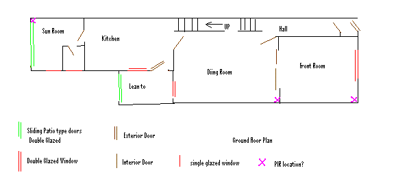

Guest RichardS Posted June 1, 2006 Share Posted June 1, 2006 Thanks everyone for the initial feedback - it is a 2 bed terraced house, attached is a (very rough) ground floor floorplan. To give an idea of scale the lounge and dining areas are approx 12' x 11' each, kitchen 10'9" x 8'. I've marked proposed PIR locations for a DIY job probably with an additional door/window contact on the bathroom window which overlooks the flat roof over the sun room. Rjbsec: - that's what I figured but thought I'd ask just in case - although I have confidence in myself I really don't want to look out the front window one night and see all my neighbours in a fit of false alarm rage coming up the road waving burning torches and pitchforks! None of the companies I have spoken to yet have hinted at the sort of arrangement you mention but I suppose it never harms to ask. Rich: - I think I could do a DIY, previous stuff I've done is set up and cable LAN's (domestic and small office - 35 machines), fit a ring main and separate lighting circuit, made an onboard preamp for one of my guitars from instructions... Link to comment https://www.thesecurityinstaller.co.uk/community/topic/10755-thank-you-all-so-much/#findComment-101050 Share on other sites More sharing options...
