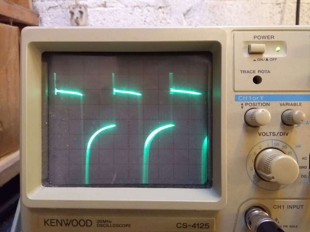

120 V AC. Presumably that's RMS , because peak voltage is nearly 250 to 300 V. This is the waveform on a scope. Anyway I had a stroke of luck. My old sounder has the exact same piezo transducer so I'm going to use that. Hopefully it's the same voltage, but it looks totally identical. The HKC sounder is taking nearly 200 mA when sounding after I replaced the piezo element, which tallies with the 250 mA peak they give in the spec. Also the 6 V battery is still working fine. After 15 mins of alarming, voltage fell to 5.75 V.

Yes, that worked. The next thing is to open the transducer to see if anything can be fixed, probably not. Also I'll put a scope on the sounder output on the board to see what has happened. A cheap meter shows 77 V instead of 120 V, but that's possibly because the meter has a limited bandwidth. Alternatively one of the drive transistors/MOSFETS may have blown.

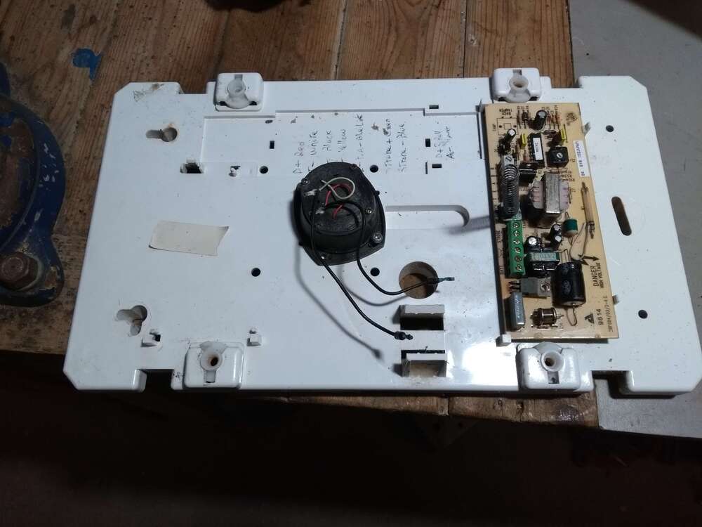

I've taken my sounder off the wall and I'm checking it on my workbench. It's powered from a desk power supply set to 12 V, connected to the external bell input terminals. I would have thought it would activate with the back tamper open, but it didn't. I closed the back tamper for 4 seconds and opened it and it still didn't activate and tried the same with the battery connected. Shouldn't all of these tamper conditions and also open circuit holds activate the unit? If a burglar cuts the cable, shouldn't the 6 V battery activate it, or is it only edge triggered (i.e when the tampers were initially closed when the sounder was powered down and then opened that triggers it? ) In this case, how can I generate a false alarm? Which terminals do I need to connect?

There are two problems I think. When the panel is powered down and the battery disconnected, the sounder is barely audible, suggesting the battery is at fault. With everything powered up, the sounder volume randomly increases and decreases and has a "scratchy" sound, like when the volume control on a radio is bad. So like you suggested previously, possibly the piezo element at fault too. I'm going to open it up today.

I wrote the colours of the wires on the inside of the sounder enclosure and what terminals they connect to when I installed it, for scenarios like this. I notice when I open the lid of my panel, it detects the tamper and keeps beeping, but the alarm doesn't sound. Maybe I set it that way, or that's the default. The alarm sounds when the panel is armed and the lid is opened, as expected. Also I powered down the panel and disconnected its battery and the volume from the sounder was really low, suggesting the battery in it is pretty much dead (no LEDs lit either). When the battery in the panel is connected and also mains power, volume from the sounder is still scratchy and volume randomly increases and decreases, suggesting a secondary problem of a bad piezo element as you suggested or maybe corroded connections.
