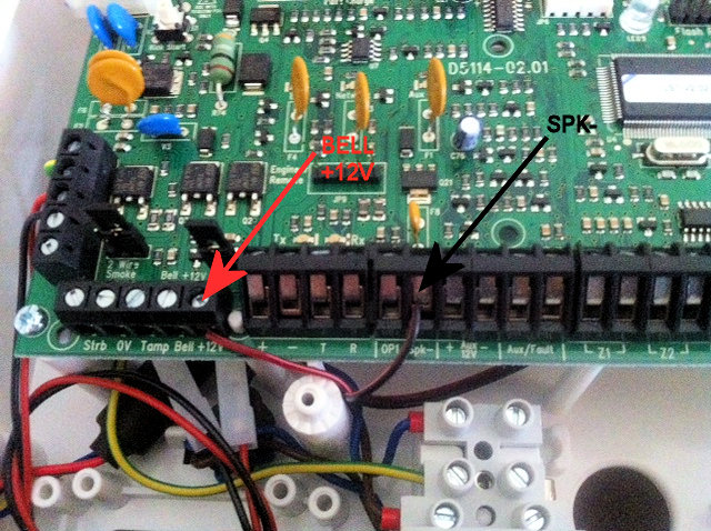

  2. Evening. Unfortunately the SB didn't work with the suggestions made. Whenever I connected the black wire to the bell, it continued to beep. I then tried 0v, the aux, the -, but connecting to any of these meant the SB just continued beeping non-stop. The only solution was to plug the black wire into the Speaker - and this stopped it. Now it only sounds whenever I do a speaker test or when the alarm actually triggers

  6. Sorry, but I'm totally confused. I'd be very grateful if you could possibly edit the picture above and do two new arrows pointing towards where you want me to connect the wires.
  7. So for bell - I think that is 0V (next to Strobe) ????
  8. The current sound bomb wiring connections are as the image shows below, i.e. RED going to BELL +12V and BLACK going to SPK-. Please note that this image is just an example off the internet and is not my actual alarm, but it's the same layout. So have I done it wrong?
  9. My apologies, but I'm not exactly sure what and where you want me to connect the wires to. Also I'm not sure where the system gets 12v output under alarm conditions.

  11. Hi guys, Thanks to many of you on here, I'm slowly getting to understand the system and have been playing around with it's settings to match it to our needs. One of the things I don't like about the texecom premier elite 24 is how quiet it's panel's internal speaker is. So I've bought a Twin Piezo Sound Bomb from Alert Electrical:- I've connected the red wire to the panel's 12v bell and the black wire to the panel speaker's -ve However it still sounds really quiet and I'm wondering if I've wired it correctly. Could anyone please confirm if this is correct and if so, how can I test that it's working correctly? Thanks again
