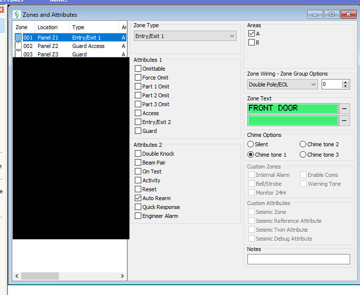

Thank you sixwheeledbeast. On prev page, where I've posted the Area3 screenshot, it already is Timed Exit. Also you say you wouldn't use the Area Arm suites, but this is now becoming confusing, because I'm not sure which options need to be enabled/disabled as I've got two different advises.. Could I please ask u a big favour? Using all the screenshots that I've posted, could you please draw or at least clearly explain PER screenshot what you want me to change, enable or disable. -

Mrhappy and Sixwheeledbeast - I'm really sorry guys, but you'll have to be very specific for a dummy like me. What screenshot are each of you referring to and what options do I need to enable/disable? Thanks again -

I think it's easier if I posted screenshots for you to check. Please let me know if you can spot any mistakes. Thank you. -

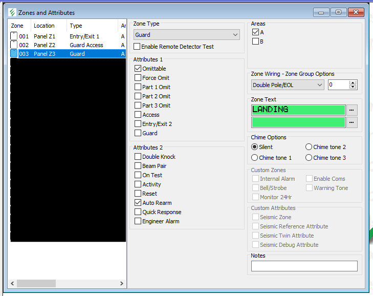

@sixwheeledbeast - But the alarm is set to auto arm as soon as the fob is scanned, so I don't get a choice to choose part or full as I think it automatically sets it to full arm. I've tried it after enabling Part 1 Omit, but it still triggers off. Also in order to actually arm it once the alarm fob has been scanned, I have to open the front door and then close it. This is the only time the alarm then fully-arms. @al-yeti - LOL! I only blanked stuff, because I just wasn't sure what was okay to post...sorry @Danny May - Problem with wireless extender is you have to always leave the internet on, but we turn ours off. -

How would part-arm omit effect the alarm during the day? Will the landing sensor not work at all? -

Thanks for that. So other than enabling Part 1 Omit for the Landing sensor, do I need to change any of the other settings on the remaining sensors? What is Part 1 Omit btw? Also I don't use a code as I have a fob to scan. But the way it's setup is that as soon as it's scanned, the alarm starts it's countdown, i.e. no options. This is because the missus doesn't know how to use it and was setup for her. I'm sometimes out due to work reasons for a few days every month, so she has to use it. I know this is a bit of a long-shot, but is there any way that it automatically can detect by the time that it needs to part-arm for the bed? -

Hi everyone, Thanks for your help. Sorry I forgot to mention that I also have a detector on the door. I set this alarm up myself, but with a lot of help from a friend, whom is now not available as he's gone abroad. I have some understanding, but not adept at using wintex, other than to change code etc. What I've done though to help you guys is attach 3 screenshots of wintex, showing the Front Door (Door Contact), Hallway & Landing settings. I hope this helps, but if you require any other info, then please let me know. Thank you. PS. I'VE BLACKED OUT THE REST OF THE ZONES -
Morning everyone, With it now being darker, I've got to be more security conscious than before and think about family safety, especially with high burglary rates around our area. My main goal is to somehow enable the alarm to be activated at night-time, so that if someone breaks in downstairs, then the alarm triggers. My current setup is 3 pirs in living/kitchen rooms and 1 in hallway, which is also where the keypad is located. I also have a pir detector on the upstairs landing. All of the alarm settings can be controlled with my pc as I have wintex installed and it's networked to the alarm. Here is the dilemma:- 1. If we enable the keypad from downstairs, then once the alarm is activated, the landing pir will trigger if there is movement. So firstly I want to be able to disable this pir for the night, so that family can still use bathroom. 2. How can I disable the alarm via the keypad, when we wake up in the morning, without triggering the hallway pir? Thank you for your help
