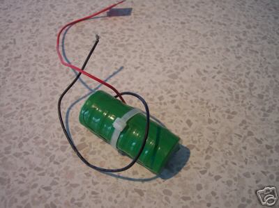

ranger Posted March 18, 2006 Share Posted March 18, 2006 Hey all, Ive got a customer with a british gas alarm box which isnt working from down on the ground, ive checked it has been wired in which it has so i assume its time for a battery replacement. Ive never used a british gas bell box before so am wondering if the batterys i use will work with it, ive attached a picture below. They are 2 1/4" tall x 1"Diameter and are Ni Cad at 8.4 volts intended for SAB. , Regards and best wishes, Ranger The above is my personal opinion and not that of my employer or anyone else. Link to comment https://www.thesecurityinstaller.co.uk/community/topic/9800-bell-box-battery/ Share on other sites More sharing options...

morph Posted March 18, 2006 Share Posted March 18, 2006 Are you sure its not a dummy box and that there is an internal sab!! British Gas generally monitored with dummy box. Link to comment https://www.thesecurityinstaller.co.uk/community/topic/9800-bell-box-battery/#findComment-91163 Share on other sites More sharing options...
ranger Posted March 18, 2006 Author Share Posted March 18, 2006 Yes my first impression was monitored with internal SAB and dummy on front and back. Internal SAB working fine but apparently, according to home owner, there is a wire leading to the bell box in the loft. As i say, i havent been there for very long, only a few minutes the other day to stop a warning problem for them and will be doing a take over on monday. The above is my personal opinion and not that of my employer or anyone else. Link to comment https://www.thesecurityinstaller.co.uk/community/topic/9800-bell-box-battery/#findComment-91182 Share on other sites More sharing options...
WatchdogSecurity Posted March 18, 2006 Share Posted March 18, 2006 Yes my first impression was monitored with internal SAB and dummy on front and back.Internal SAB working fine but apparently, according to home owner, there is a wire leading to the bell box in the loft. As i say, i havent been there for very long, only a few minutes the other day to stop a warning problem for them and will be doing a take over on monday. arent the Britsh Gas boxes Novagard Deltas ?? just trying to picture one in my head, if it is and it isnt a dummmy you should be able to swap out the nicad. Watchdog Security (Manchester) Link to comment https://www.thesecurityinstaller.co.uk/community/topic/9800-bell-box-battery/#findComment-91186 Share on other sites More sharing options...
Alarm Protection Posted March 18, 2006 Share Posted March 18, 2006 They are Deltas. Round my area the front box is live with a dummy at the back. ! Link to comment https://www.thesecurityinstaller.co.uk/community/topic/9800-bell-box-battery/#findComment-91192 Share on other sites More sharing options...
sparky83 Posted March 18, 2006 Share Posted March 18, 2006 I had one ringing in my ear back last year and couldnt see a terminal to remove the battery from the sounder so after a bit of a panic I just put the cover back on. Dont forget theres a 1k resistor across the 12V+ and trigger if you have problems. Not sure whether its built into these sounders or whether its just simply placed in the internal sounders. Trade Member Link to comment https://www.thesecurityinstaller.co.uk/community/topic/9800-bell-box-battery/#findComment-91193 Share on other sites More sharing options...
