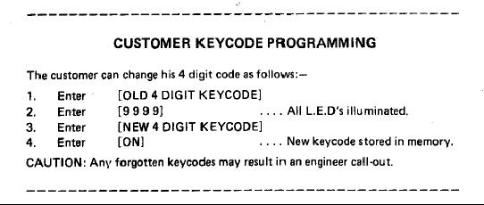

Brian c Posted October 21, 2005 Share Posted October 21, 2005 Not too sure of the model numbers, but this is from the Symphony 234.... This is all the info we can give you from the manual. If you have lost the original code you will need an engineer. (looks like they assumed all their customers would be male) If you don't know......ask. Link to comment https://www.thesecurityinstaller.co.uk/community/topic/7895-help-me/#findComment-72974 Share on other sites More sharing options...
