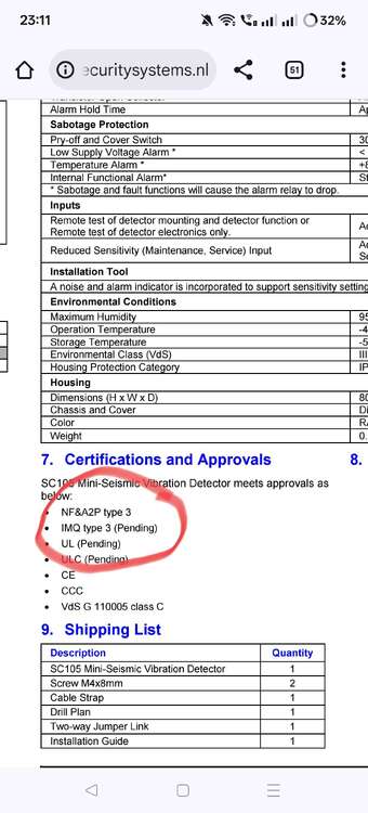

w20oda Posted 4 hours ago Posted 4 hours ago Hi All, Bit of a compliance question here... We have been asked to fit Honeywell SC100 seismic sensors on a G3 system however the SC100's dont seem to bear any security grading. I know these are used industry wide and they are "the right" bits of kit for the job but how can they be fitted on a graded system without affecting the overall system grading? Quote
al-yeti Posted 3 hours ago Posted 3 hours ago 1 hour ago, w20oda said: Hi All, Bit of a compliance question here... We have been asked to fit Honeywell SC100 seismic sensors on a G3 system however the SC100's dont seem to bear any security grading. I know these are used industry wide and they are "the right" bits of kit for the job but how can they be fitted on a graded system without affecting the overall system grading? I would have thought they have some other kind of certification as opposed to stating they are grade 2/3 Quote
w20oda Posted 3 hours ago Author Posted 3 hours ago They have some German VDS approvals but nothing which is UK specific. Quote
