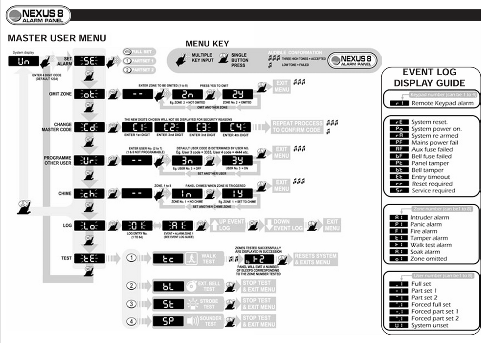

james.wilson Posted June 11 Share Posted June 11 this shows the process Quote securitywarehouse Security Supplies from Security Warehouse Trade Members please contact us for your TSI vetted trade discount. Link to comment https://www.thesecurityinstaller.co.uk/community/topic/47252-nexus-8-wired-alarm/#findComment-530056 Share on other sites More sharing options...
PeterJames Posted June 11 Share Posted June 11 To put that in english: Type the user code that works, press no till you get to CD press Yes then enter the four digits you want to use, and again a second time to confirm Quote Link to comment https://www.thesecurityinstaller.co.uk/community/topic/47252-nexus-8-wired-alarm/#findComment-530061 Share on other sites More sharing options...
