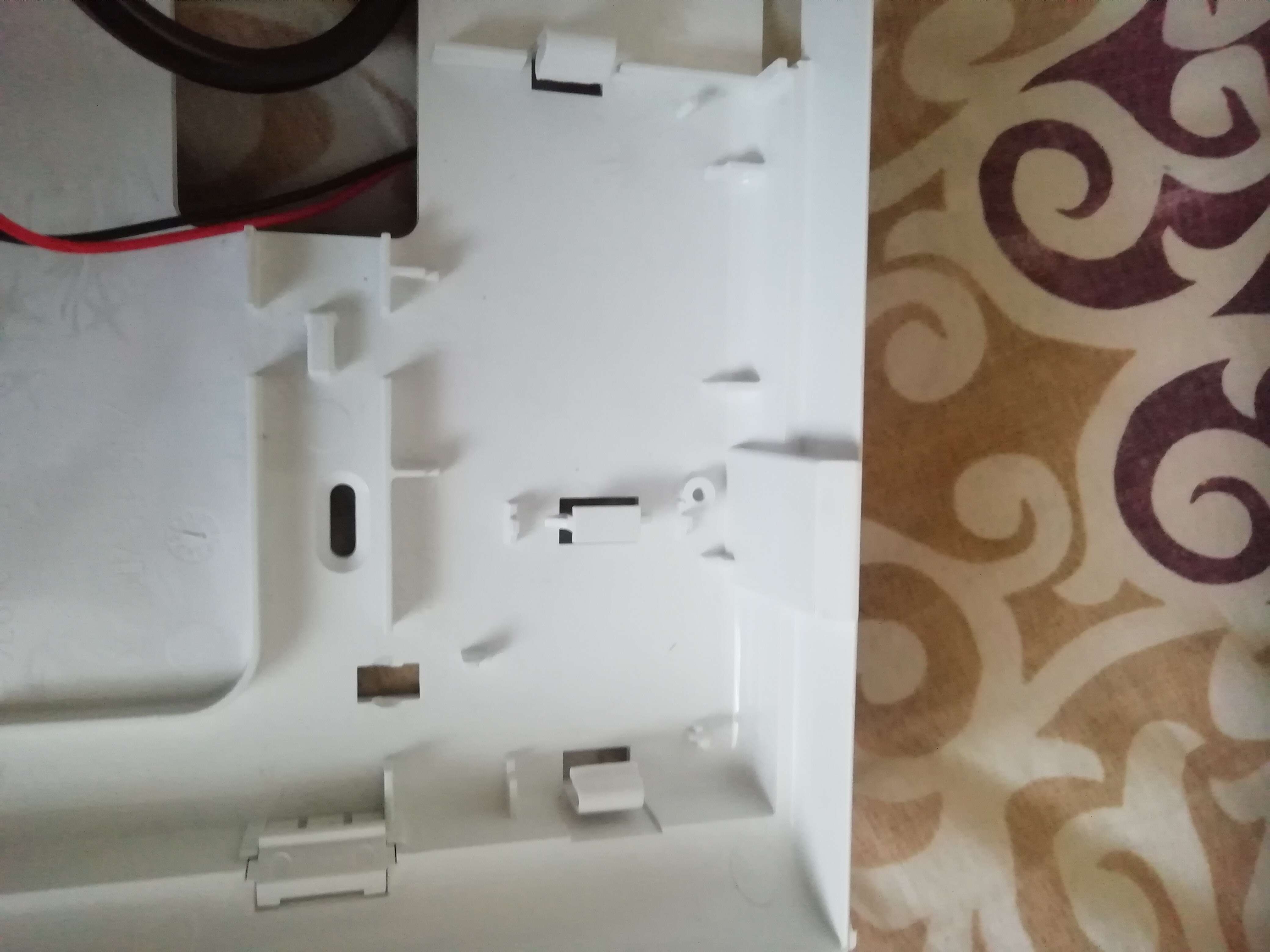

Naeem ahmed Posted April 19, 2023 Author Share Posted April 19, 2023 Hi James I just received from a supply a modual for connecting a hardwired bell but module looksto small and won't fit correctly please can you check my pic of module he sent to me Kind regards Naeem Link to comment https://www.thesecurityinstaller.co.uk/community/topic/45570-visonic-powermax-complete/page/2/#findComment-518593 Share on other sites More sharing options...
james.wilson Posted April 19, 2023 Share Posted April 19, 2023 sorry I've never fitted one securitywarehouse Security Supplies from Security Warehouse Trade Members please contact us for your TSI vetted trade discount. Link to comment https://www.thesecurityinstaller.co.uk/community/topic/45570-visonic-powermax-complete/page/2/#findComment-518595 Share on other sites More sharing options...
Naeem ahmed Posted April 19, 2023 Author Share Posted April 19, 2023 Ok thanks for getting back to me do you know if this 1 is the correct 1 Visonic Powermax Complete Expander Module 9-100775 Kind regards Naeem Link to comment https://www.thesecurityinstaller.co.uk/community/topic/45570-visonic-powermax-complete/page/2/#findComment-518596 Share on other sites More sharing options...
Naeem ahmed Posted April 19, 2023 Author Share Posted April 19, 2023 Hi James it's ok I fitted it now thanks once again for getting back to me your help and advice is wonderfull always Kind regards Naeem Link to comment https://www.thesecurityinstaller.co.uk/community/topic/45570-visonic-powermax-complete/page/2/#findComment-518599 Share on other sites More sharing options...
