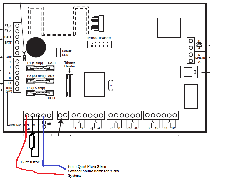

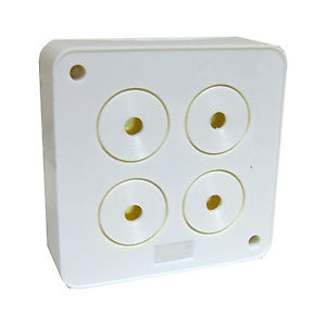

Hine1789 Posted November 13, 2013 Author Share Posted November 13, 2013 You have probably overloaded it I have checked and not overloaded so I have removed one and left one on to check but the same thing. I have checked the volume and it is on the default volume. Link to comment https://www.thesecurityinstaller.co.uk/community/topic/35631-honeywell-galaxy-g2-12/page/2/#findComment-354303 Share on other sites More sharing options...
goncall Posted November 13, 2013 Share Posted November 13, 2013 I have checked and not overloaded so I have removed one and left one on to check but the same thing. I have checked the volume and it is on the default volume. that's for the speaker not the sounder,pic will help.. Link to comment https://www.thesecurityinstaller.co.uk/community/topic/35631-honeywell-galaxy-g2-12/page/2/#findComment-354309 Share on other sites More sharing options...
Hine1789 Posted November 13, 2013 Author Share Posted November 13, 2013 that's for the speaker not the sounder,pic will help.. This is what I have done... Â This is what I am connecting to my panel. Â This is how I have wired it up. Link to comment https://www.thesecurityinstaller.co.uk/community/topic/35631-honeywell-galaxy-g2-12/page/2/#findComment-354327 Share on other sites More sharing options...
james.wilson Posted November 14, 2013 Share Posted November 14, 2013 Well that looks right, when in alarm what does your meter read across those 2 terminals securitywarehouse Security Supplies from Security Warehouse Trade Members please contact us for your TSI vetted trade discount. Link to comment https://www.thesecurityinstaller.co.uk/community/topic/35631-honeywell-galaxy-g2-12/page/2/#findComment-354357 Share on other sites More sharing options...
