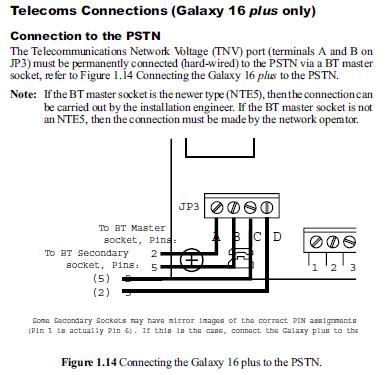

pmg Posted November 4, 2010 Author Share Posted November 4, 2010 Thanks James. Can you send me the connection info you referred to below ? Link to comment https://www.thesecurityinstaller.co.uk/community/topic/30072-can-galaxy-16-seize-busy-phone-line/#findComment-256758 Share on other sites More sharing options...
james.wilson Posted November 4, 2010 Share Posted November 4, 2010 see image securitywarehouse Security Supplies from Security Warehouse Trade Members please contact us for your TSI vetted trade discount. Link to comment https://www.thesecurityinstaller.co.uk/community/topic/30072-can-galaxy-16-seize-busy-phone-line/#findComment-256763 Share on other sites More sharing options...
