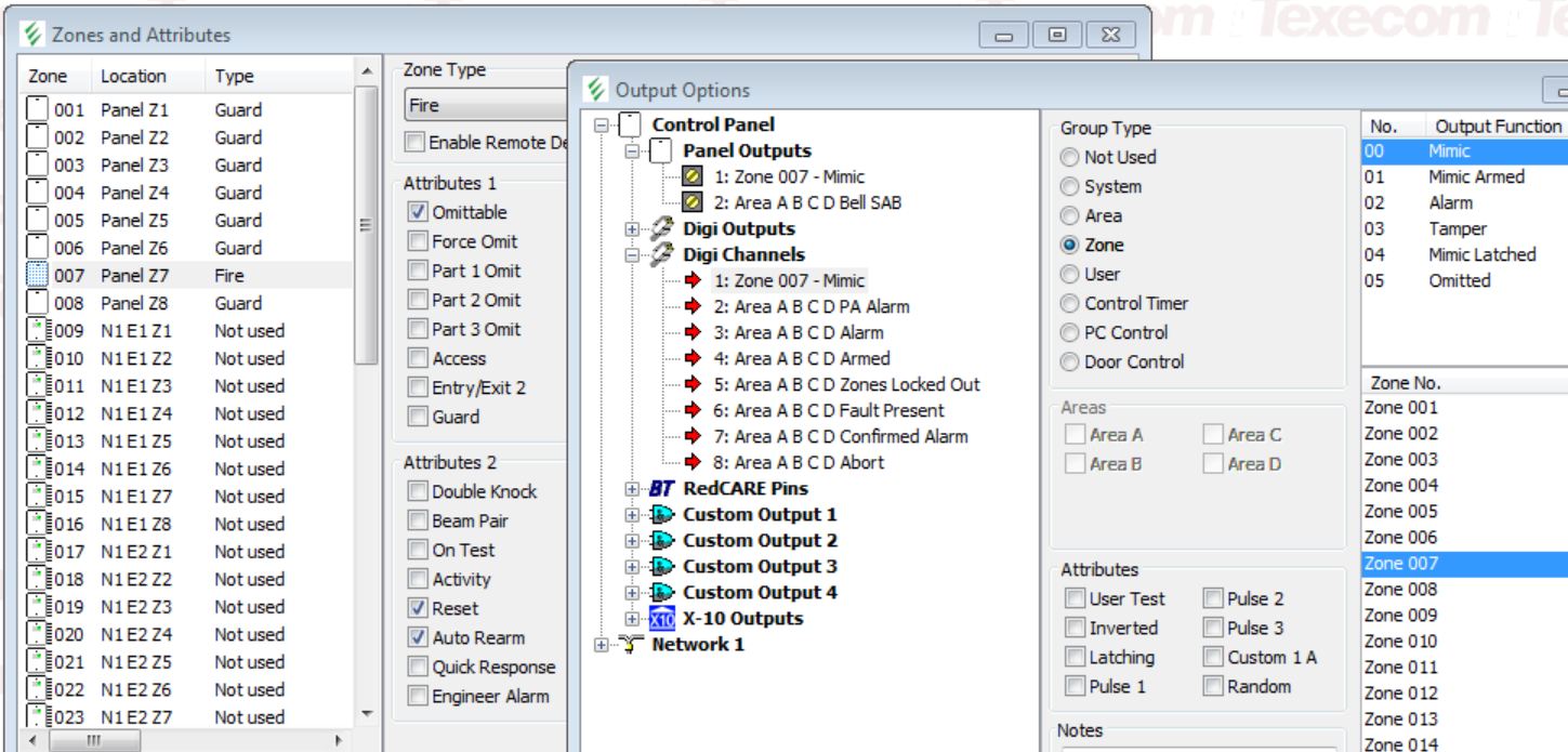

Toni42 Posted July 9, 2010 Share Posted July 9, 2010 This will beat! sorry for the pun! any head bangers night out Zone 7 Fire ---> to output 2 on panel output 2 wired as pizeo zone 7 shows as healthy 4 wire exodus dp resistance correct when in NC/OC states. output configured as zone mimic Digital as zone mimic for sending sms data via onboard com2400 for some reason no sms gets through, yet all the other zone configs send sms without any issue, eg pir zone 3 area A sends the following text hes getting thorough the duckin window get your false teeth and run! see below for GUI Link to comment https://www.thesecurityinstaller.co.uk/community/topic/29318-texecom-premier-48-op1-op2/ Share on other sites More sharing options...

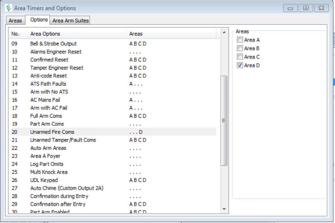

breff Posted July 9, 2010 Share Posted July 9, 2010 Digi channels dont send on Sms texting, only on fast format If you want to send fire always turn on unarmed fire coms in area options The opinions I express are mine and are usually correct! (Except when I'm wrong)(which I'm not) Link to comment https://www.thesecurityinstaller.co.uk/community/topic/29318-texecom-premier-48-op1-op2/#findComment-245040 Share on other sites More sharing options...

Toni42 Posted July 10, 2010 Author Share Posted July 10, 2010 Any one willing to assist? zone 7 fire (exodus smoke heat) mimic ---> zone 7 fire ---> control panel output ---> 12v pizeo sounder This zone is not reported via sms using the comm 2400 whilst all the other 9 zones work fine and report via sms Regards tony thnks Link to comment https://www.thesecurityinstaller.co.uk/community/topic/29318-texecom-premier-48-op1-op2/#findComment-245176 Share on other sites More sharing options...
breff Posted July 10, 2010 Share Posted July 10, 2010 What area is zone 7 assigned to? As I said earlier though, digi channels have nothing to do with SMS texting, what is sent by SMS is determined by what attributes are assigned in the reporting options The opinions I express are mine and are usually correct! (Except when I'm wrong)(which I'm not) Link to comment https://www.thesecurityinstaller.co.uk/community/topic/29318-texecom-premier-48-op1-op2/#findComment-245189 Share on other sites More sharing options...
Toni42 Posted July 10, 2010 Author Share Posted July 10, 2010 the attributes in version 8 software for a setting of fire seem to choose reset no other attributes other than auto re arm the only other option since it is an optical sensor would be to give it guard attribute but I am not sure? seems odd that when selecting fire that reset attribute selects automatically but nothing else. thanks Tony Link to comment https://www.thesecurityinstaller.co.uk/community/topic/29318-texecom-premier-48-op1-op2/#findComment-245192 Share on other sites More sharing options...
