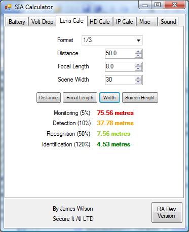

james.wilson Posted June 13, 2010 Share Posted June 13, 2010 ok then cam 1 Ill assume you want a 4m scene width on this one if so you need a 60mm lens at 1/3" camera wise id recommend the stuff we use a bosch dinion Lighting wise i wouldnt use anything with built in ir and id suggest a fairly manly spot ir unit cam 2 As your saying 20 sq m then im assuming you would normally use an el cheapo type integrated ir bullet / dome. If so id carry on with that but use one witha varifocal lens cam 3 as above cam 4 Assuming a 20m view and as its a patio a 10m scene width? if so a 9.6mm lens A bit more info for ya on camera 1 the guidlines are for recognition etc that you need a certain % of screen height for a 1.7m target, again techmaster will give you these values but 5% Monitoring = 566m 10% Detection = 283m 50% recognition = 56.67m 120% Identification = 34m but on cam 3 on an 8mm lens 5% Monitoring = 75m 10% Detection = 37m 50% recognition = 7.5m 120% Identification = 4.53m as cam 3 im assuming the target could be 10m away then you may never achieve recognition. The only way around this is to use a longer focal length and restrict the scene area, or up the pixel count recorded (ie not PAL) Hope that helps James ps cam choice is a whole seperate debate lol securitywarehouse Security Supplies from Security Warehouse Trade Members please contact us for your TSI vetted trade discount. Link to comment https://www.thesecurityinstaller.co.uk/community/topic/29090-camera-recommendation/#findComment-241696 Share on other sites More sharing options...
