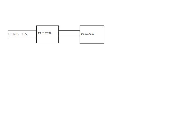

marx Posted May 22, 2009 Share Posted May 22, 2009 i know that that if u have broadband then u need filter for every phone or device that uses phone line. r u sure they r all before phones and calldialer. I got we drawing here for u. mabe that helps. i think u have there something front of the filter and thats the problem. Link to comment https://www.thesecurityinstaller.co.uk/community/topic/28801-lynteck-ls400-voice-dialer-with-to-scantronic-9600/#findComment-238207 Share on other sites More sharing options...

marx Posted May 22, 2009 Share Posted May 22, 2009 that looks right yes. might be faulty filter. one thing u can try is that disconect everything part of dialler and test it and then add your phones one by one and test it, then the faulty one might come out. how did u connected filter for dialler? is it just blugs or did u had to cut the cable and connect filter? Link to comment https://www.thesecurityinstaller.co.uk/community/topic/28801-lynteck-ls400-voice-dialer-with-to-scantronic-9600/#findComment-238212 Share on other sites More sharing options...
