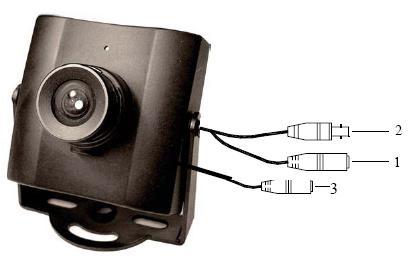

bgd Posted March 10, 2009 Author Share Posted March 10, 2009 Thanks Paul, If using just the existing housing, do I need to protect the lense as there is no any additional glass in front of it like on conventional housings? This is the picture of the actual camera. Link to comment https://www.thesecurityinstaller.co.uk/community/topic/27448-external-housing-for-vista-board-cameras/#findComment-228272 Share on other sites More sharing options...
