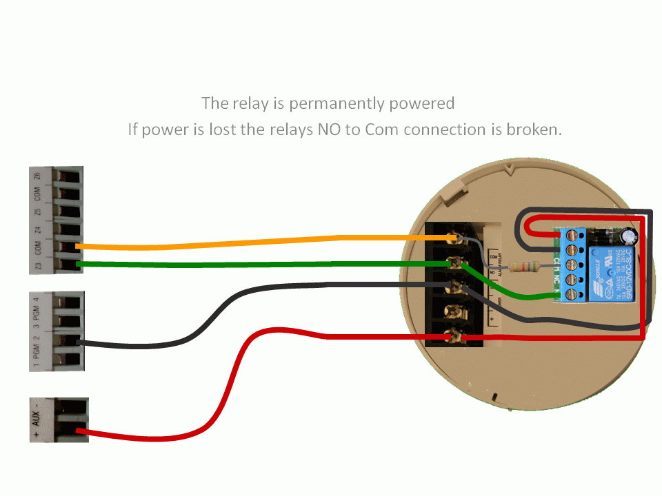

NitroN Posted October 4, 2008 Share Posted October 4, 2008 That depends on the model of the smoke detector. Normally I would not try to explain this on an open forum, but seeing as I do not have access to the trade forum and that Redbull and Angus have asked... Two wire 12v smoke detectors, when wired to a 2 wire smoke detector circuit will go open if there is no voltage. Four wire 12v smoke detectors typically have a built in relay, but this is normally designed to trigger a remote indicator. (i.e. a strobe outside the area that the smoke detector is installed in. While many installers just connect the suitable resistor in parallel to the normally open smoke detector circuit, this will work, but the panel will not be able to monitor power (as this is a NO Circuit). To do this correctly: 1. The smoke detectors power should be connected to a resettable panel power supply, this is normally either a dedicated smoke detector power supply or a programmable output. 2. The smoke detectors are connected in parallel to the panel, but in series to the required resistor connected to a relay powered from the same power line as the smoke detector(s). 3. The smoke detectors zone circuits should be connected to the Com & NO terminals on the relay. (NO & Com terminals are shorted when the relay is powered Link to comment https://www.thesecurityinstaller.co.uk/community/topic/24853-smole-detectors-texecom-premier-48/page/2/#findComment-212528 Share on other sites More sharing options...

NitroN Posted October 7, 2008 Share Posted October 7, 2008 The problem with using normally closed smoke detectors is that these can cause false alarms if a wire is broken or if there is no power. If you wire them this way, (depending on how your panel's fire zone works), you will only get a fire alarm if the smoke detectors circuit goes closed. A wiring or power problem with create a fire trouble. 2 wire smoke detectors monitor this automatically and do not need a relay. Link to comment https://www.thesecurityinstaller.co.uk/community/topic/24853-smole-detectors-texecom-premier-48/page/2/#findComment-212704 Share on other sites More sharing options...
aptsys Posted October 7, 2008 Share Posted October 7, 2008 The Premier 48 accepts up to 10 2 wire smoke detectors connected between Aux 12V+ and Panel O/P 1. Obviously 4 wire smokes can be connected to a standard zone. Link to comment https://www.thesecurityinstaller.co.uk/community/topic/24853-smole-detectors-texecom-premier-48/page/2/#findComment-212715 Share on other sites More sharing options...
InspectorGadget Posted October 18, 2008 Author Share Posted October 18, 2008 That depends on the model of the smoke detector. Normally I would not try to explain this on an open forum, but seeing as I do not have access to the trade forum and that Redbull and Angus have asked...Two wire 12v smoke detectors, when wired to a 2 wire smoke detector circuit will go open if there is no voltage. Four wire 12v smoke detectors typically have a built in relay, but this is normally designed to trigger a remote indicator. (i.e. a strobe outside the area that the smoke detector is installed in. While many installers just connect the suitable resistor in parallel to the normally open smoke detector circuit, this will work, but the panel will not be able to monitor power (as this is a NO Circuit). To do this correctly: 1. The smoke detectors power should be connected to a resettable panel power supply, this is normally either a dedicated smoke detector power supply or a programmable output. 2. The smoke detectors are connected in parallel to the panel, but in series to the required resistor connected to a relay powered from the same power line as the smoke detector(s). 3. The smoke detectors zone circuits should be connected to the Com & NO terminals on the relay. (NO & Com terminals are shorted when the relay is powered Link to comment https://www.thesecurityinstaller.co.uk/community/topic/24853-smole-detectors-texecom-premier-48/page/2/#findComment-213751 Share on other sites More sharing options...
