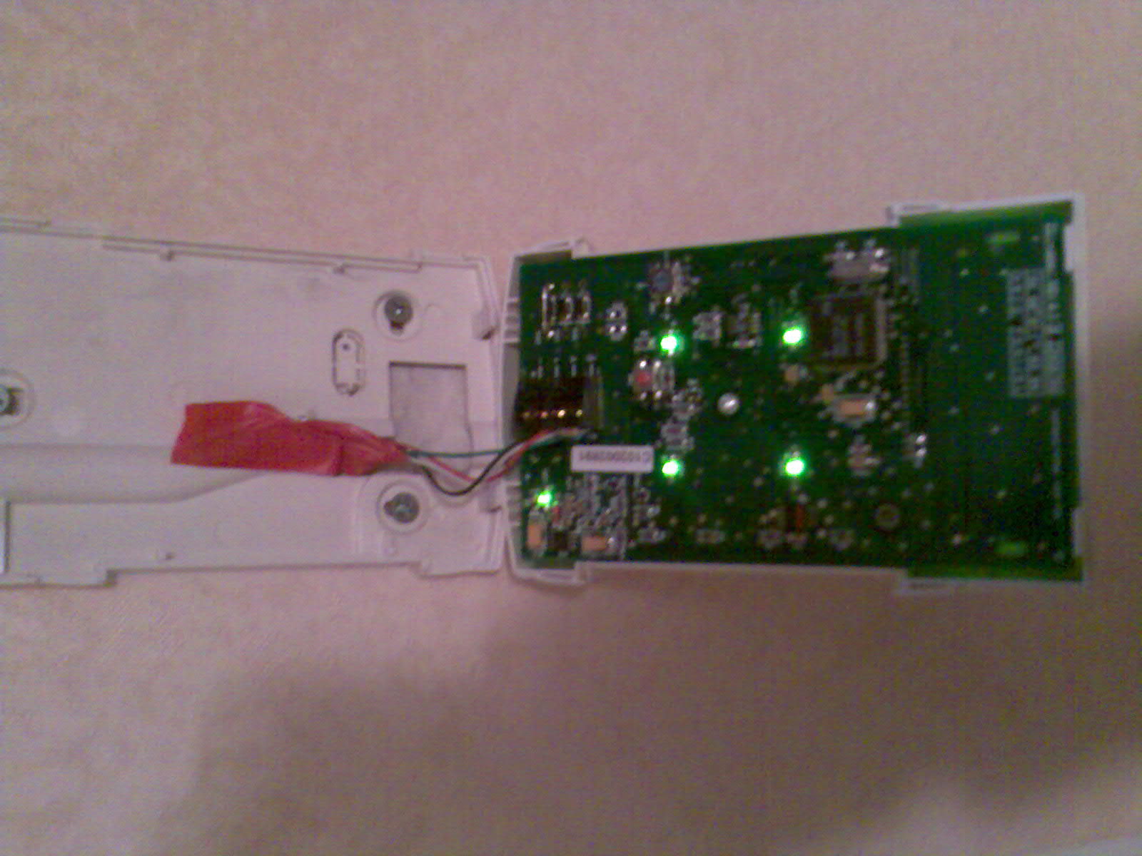

BobFinch Posted January 6, 2008 Author Share Posted January 6, 2008 Right Chaps- Job under way. Engineers Mode on. Panel cover(s) removed (one in hall and one in bedroom). But I can't see the aux. fuse. I have attached a photo (hopefully) and would be grateful if you could describe where fuse is. Thanks Link to comment https://www.thesecurityinstaller.co.uk/community/topic/21815-galaxy-16-moving-a-detector/page/2/#findComment-187667 Share on other sites More sharing options...
amateurandy Posted January 6, 2008 Share Posted January 6, 2008 Panel cover(s) removed (one in hall and one in bedroom). But I can't see the aux. fuse. Are you sure that's the control panel and not just a remote keypad? Link to comment https://www.thesecurityinstaller.co.uk/community/topic/21815-galaxy-16-moving-a-detector/page/2/#findComment-187669 Share on other sites More sharing options...
satsuma01 Posted January 6, 2008 Share Posted January 6, 2008 Right Chaps-Job under way. Engineers Mode on. Panel cover(s) removed (one in hall and one in bedroom). But I can't see the aux. fuse. I have attached a photo (hopefully) and would be grateful if you could describe where fuse is. Thanks Bob i meant in the main alarm panel you need to remove BOTH screws top and bottom and that will be where the main 7ah or equiv battery will be. the photo shows the KEYPADS IMAGE NOT THE PANEL banghead "If you carry your childhood with you, you never become old. Why rush to end life when happiness is in the blissfulness of childhood innocence.""We all die, the goal isn't to live forever, the goal is to create something that will." 07475071344 Link to comment https://www.thesecurityinstaller.co.uk/community/topic/21815-galaxy-16-moving-a-detector/page/2/#findComment-187670 Share on other sites More sharing options...

BobFinch Posted January 6, 2008 Author Share Posted January 6, 2008 Right. I thought you meant the keypad panel! The main panel is in the loft. I will put the bits back together and carry on later (or tomorrow). Meanwhile I will go and see if Liverpool are having more sucess in the FA Cup than I am having with electronics! Thanks again. Link to comment https://www.thesecurityinstaller.co.uk/community/topic/21815-galaxy-16-moving-a-detector/page/2/#findComment-187672 Share on other sites More sharing options...

BobFinch Posted January 6, 2008 Author Share Posted January 6, 2008 Half-time. Keypads re-asembled but now indicate "Tamper" on "Keypad 1". Hmmm, I wonder how that happened? Keypad will not now allow me to exit from Engineers Mode. Any ideas please? Link to comment https://www.thesecurityinstaller.co.uk/community/topic/21815-galaxy-16-moving-a-detector/page/2/#findComment-187678 Share on other sites More sharing options...
Guest anguscanplay Posted January 6, 2008 Share Posted January 6, 2008 Half-time.Keypads re-asembled but now indicate "Tamper" on "Keypad 1". Hmmm, I wonder how that happened? Keypad will not now allow me to exit from Engineers Mode. Any ideas please? take it apart and refit it again - chances are the little micro switch isnt making properly ( but dont let Arf lead you astray with resistors etc ) sorry little forum humour there Link to comment https://www.thesecurityinstaller.co.uk/community/topic/21815-galaxy-16-moving-a-detector/page/2/#findComment-187680 Share on other sites More sharing options...
magpye Posted January 6, 2008 Share Posted January 6, 2008 Half-time.Keypads re-asembled but now indicate "Tamper" on "Keypad 1". Hmmm, I wonder how that happened? Keypad will not now allow me to exit from Engineers Mode. Any ideas please? The 'tamper switch' on 'Keypad 1' has not "made" Suggest Keypad 1 is the one closest to your final exit, open again and re-close (don't forget to have a look for the tamper switch, spring missing?) Someone told me I was ignorant and apathetic, I don't know what that means, nor do I care. Link to comment https://www.thesecurityinstaller.co.uk/community/topic/21815-galaxy-16-moving-a-detector/page/2/#findComment-187682 Share on other sites More sharing options...
