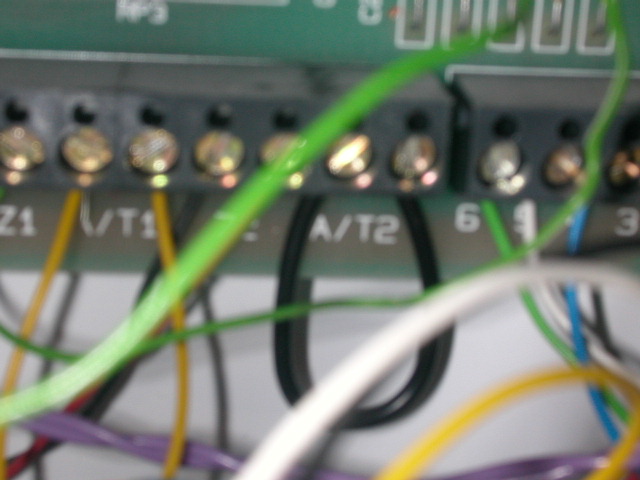

Guest mikeyb Posted March 21, 2004 Share Posted March 21, 2004 a black and red wire is connected in the two terminals of zone 2 and it leads to another small circuit thing but it has a red light on wheres the other little circuit doenst. the pic is of the connections of A/T Link to comment https://www.thesecurityinstaller.co.uk/community/topic/1774-help-please/#findComment-9798 Share on other sites More sharing options...
Guest mikeyb Posted March 21, 2004 Share Posted March 21, 2004 a black and red wire is connected in the two terminals of zone 2 and it leads to another small circuit thing but it has a red light on wheres the other little circuit doenst. the pic is of the connections of A/T Link to comment https://www.thesecurityinstaller.co.uk/community/topic/1774-help-please/#findComment-9799 Share on other sites More sharing options...
morph Posted March 21, 2004 Share Posted March 21, 2004 okay close the box and refit the cover screws. try to set and unset the system is the zone for a movement detector, a shock sensor or a door contact or something else Link to comment https://www.thesecurityinstaller.co.uk/community/topic/1774-help-please/#findComment-9800 Share on other sites More sharing options...

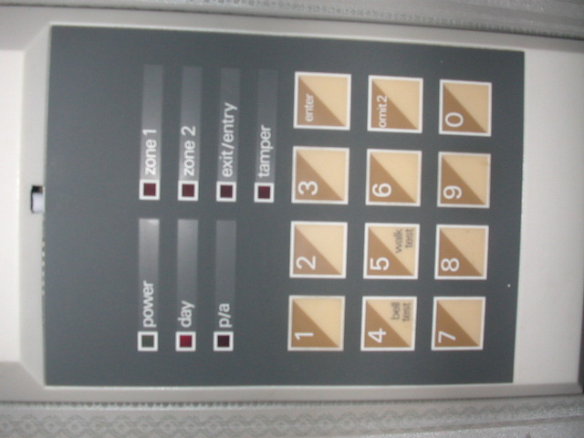

morph Posted March 21, 2004 Share Posted March 21, 2004 Is there a push button on the panel for resetting the shock sensors and is there a tamper circuit. Post a picture of the circuit board the wiring goes into. and one of the panel lights. How did the fault show up? Link to comment https://www.thesecurityinstaller.co.uk/community/topic/1774-help-please/#findComment-9803 Share on other sites More sharing options...
