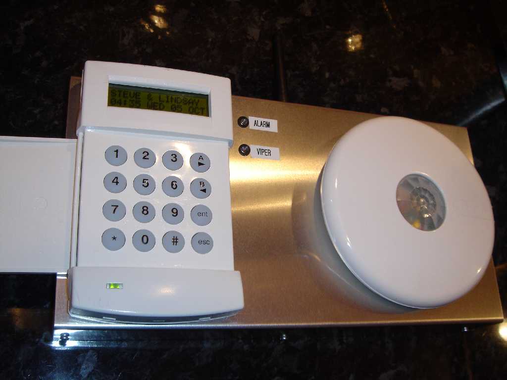

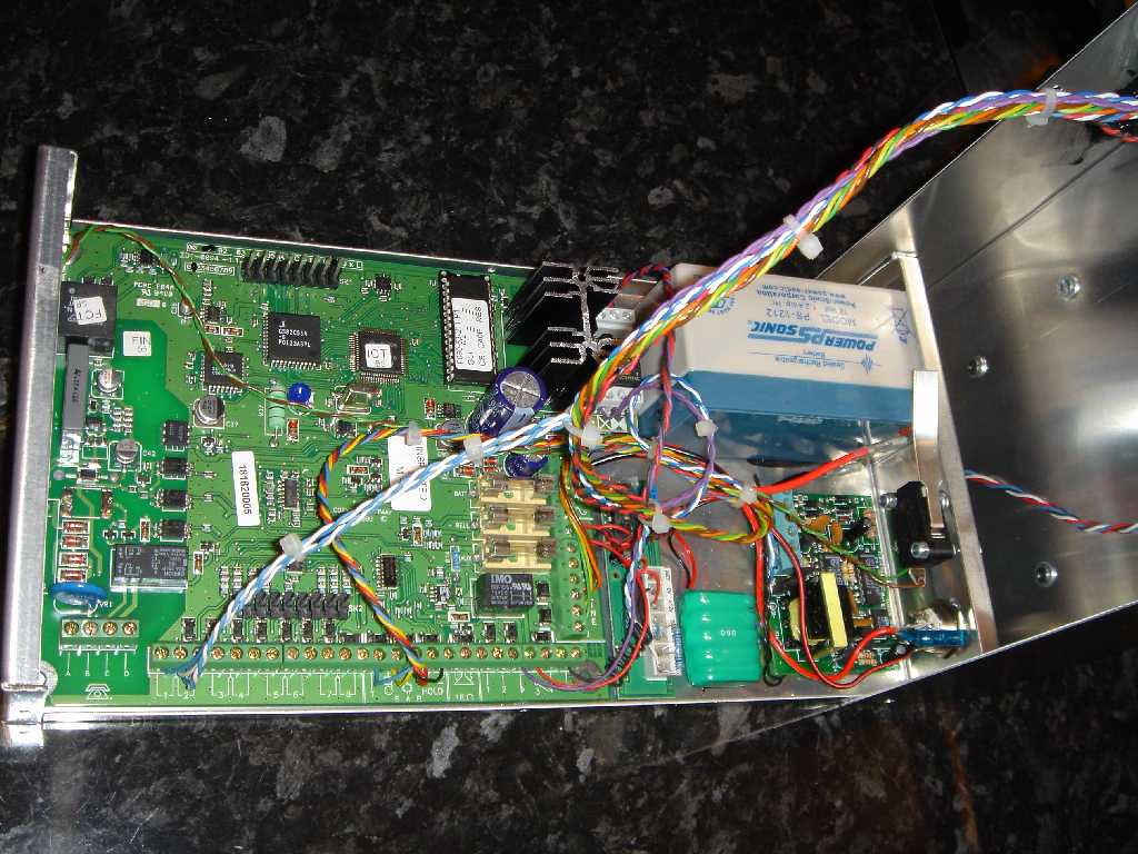

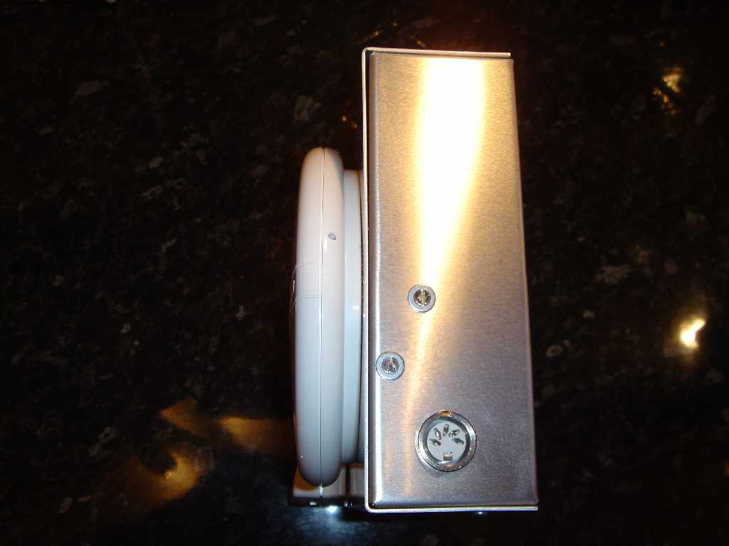

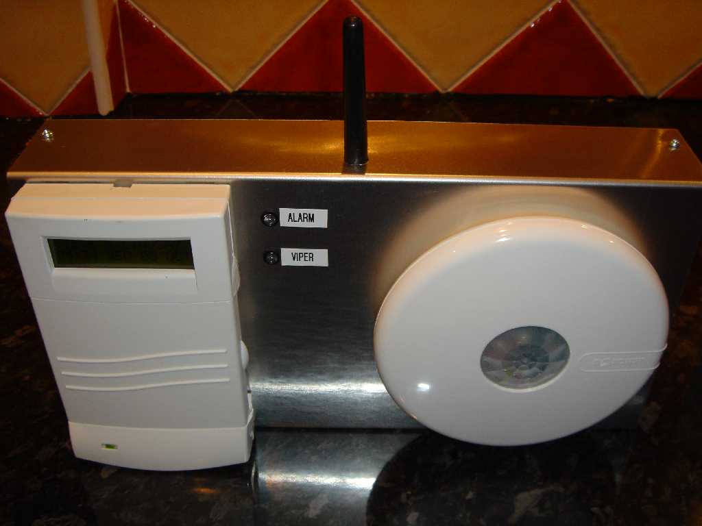

norman Posted February 11, 2007 Share Posted February 11, 2007 Ensure if you go the solar panel way that it is regulated as the cheapies are not and will boil the battery dry, also make sure as a rule of thumb that the panel will supply more than the alarm takes in quiescent mode. Here's one I made earlier. Nothing is foolproof to a sufficiently talented fool. Link to comment https://www.thesecurityinstaller.co.uk/community/topic/15615-mains-free-security-systems/page/2/#findComment-150581 Share on other sites More sharing options...
