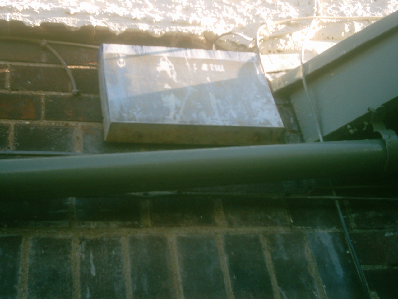

ranger Posted June 17, 2006 Share Posted June 17, 2006 Hey guys, You may remember a previous topic of mine when i was trying to identify what sounder i had found on the wall of a family business site and the trouble i had when i accidently set it off A few of you advised me to rip it down (as i cannot get to the screws due to a drain pipe) and replace it but so far i have just left it just as it is. My question now is i am going to rip it down today for a closer look and just wanted to know if anyone knew if it has a back wall tamper? As i want to know what to expect if i rip it off Its not connected to anything on the panel end so it wont be losing any connections when i rip it off. Once i have it off the wall i should be able to get inside it out of curiousity. B) guys, Ranger EDIT: Here is the picture i included in the original post: The above is my personal opinion and not that of my employer or anyone else. Link to comment https://www.thesecurityinstaller.co.uk/community/topic/11000-rapier-external-sounder/ Share on other sites More sharing options...
Guest RICHL Posted June 17, 2006 Share Posted June 17, 2006 Its not connected to anything on the panel end so it wont be losing any connections when i rip it off. It will have timed out then, so it should come off without any bother. Link to comment https://www.thesecurityinstaller.co.uk/community/topic/11000-rapier-external-sounder/#findComment-103403 Share on other sites More sharing options...
ranger Posted June 17, 2006 Author Share Posted June 17, 2006 Thanks for the reply but does it have a back wall tamper? As i know the battery (last time i checked) has charge and it might be a SAB. Ranger The above is my personal opinion and not that of my employer or anyone else. Link to comment https://www.thesecurityinstaller.co.uk/community/topic/11000-rapier-external-sounder/#findComment-103404 Share on other sites More sharing options...
Guest RICHL Posted June 17, 2006 Share Posted June 17, 2006 I would assume that it would have a rear tamper, but if as you say it is not connected to the panel anymore then it should come off the wall without sounding. Link to comment https://www.thesecurityinstaller.co.uk/community/topic/11000-rapier-external-sounder/#findComment-103405 Share on other sites More sharing options...
Service Engineer Posted June 17, 2006 Share Posted June 17, 2006 Should have a 2.1Ah battery inside, and yes shall be back tampered. ........................................................ Dave Partridge (Romec Service Engineer) Link to comment https://www.thesecurityinstaller.co.uk/community/topic/11000-rapier-external-sounder/#findComment-103406 Share on other sites More sharing options...
Guest Posted June 17, 2006 Share Posted June 17, 2006 drain pipe 1......... ranger nil a simple screw driver bit in a pair of pilers should have done the job but then its much more fun to lever it off the wall with a 3ft bar Link to comment https://www.thesecurityinstaller.co.uk/community/topic/11000-rapier-external-sounder/#findComment-103407 Share on other sites More sharing options...

ranger Posted June 17, 2006 Author Share Posted June 17, 2006 Indeed they are loud, bet the people were pleased B) Thanks for all your replies, and thanks for the tip with the screwdriver bit but the screws are rusted and very tight. Stupid drain pipes I am off to do it now so we shall see what we shall see. Ill try the screwdriver bit first as a last attempt for curiosity. for that guys. Ranger The above is my personal opinion and not that of my employer or anyone else. Link to comment https://www.thesecurityinstaller.co.uk/community/topic/11000-rapier-external-sounder/#findComment-103419 Share on other sites More sharing options...
