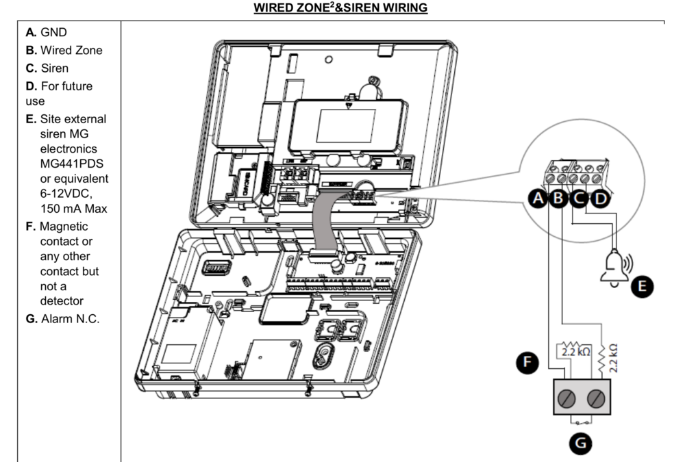

  3. The diagram below shows what it looks like and how to connect a siren. I can open it, of course, and take a picture if you prefer. I was told that I would probably need to buy an expander to connect the ADT siren but I am not convinced: Visonic ioXpander-8 Internal Wired Expander Module 9-103514 Many thanks!

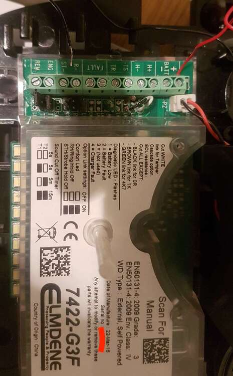

  6. I have engineer access to the alarm panel It is not ex ADT panel. I bought the panel new myself. I can download the Visonic manuals but I can't find the manual for Elmdene unfortunately. There is a QR code that you can see on the sticker on the picture. I thought it would give me a url address for the manual. Unfortunately, access to the manual under that url is restricted.
  7. Hi Logan, That is quite an unfair accusation to be thrown at someone on an open forum. I didn't steal the siren. I hid the number because I keep reading that it is a bad idea to post serial numbers on the internet. (e.g.: https://www.howtogeek.com/294471/should-i-keep-my-techs-serial-numbers-private/). Am I too paranoid? If you are so kind to provide help and for this reason, you would need the number, I am absolutely happy to send it to you. I want to connect that siren because I already have it from an older ADT alarm and I would like to use it rather than buying a new unbranded one. Do you think it s a bad idea? Many thanks, M.
  8. Hi all, I was wondering if someone could help me. I have a Visonic PowerMaster 33 G2 alarm system installed at home without any expander. I also have Elmdene 7422-G3F external siren (ADT branded). I would like to use it with my alarm system. I have two questions: - What expander would I have to buy for my alarm - How do I wire the external siren to my alarm system I attached a photo of the siren. Any help would be much appreciated.
