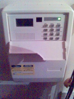

Guest pdavy Posted February 1, 2005 Share Posted February 1, 2005 Having been advised my control panel (See Below) is probably an Infra 16 I'm after a User Manual for it - Can anyone point me in the right direction to find one? Link to comment https://www.thesecurityinstaller.co.uk/community/topic/4962-user-manual-infra-16/ Share on other sites More sharing options...

Guest pdavy Posted February 1, 2005 Share Posted February 1, 2005 I should've also mentioned - It just displays 'Not Ready' in the top right of the LCD and CD (Which I'm presuming are zones?) in the bottom right of the LCD Link to comment https://www.thesecurityinstaller.co.uk/community/topic/4962-user-manual-infra-16/#findComment-39063 Share on other sites More sharing options...
ian.cant Posted February 1, 2005 Share Posted February 1, 2005 I should've also mentioned - It just displays 'Not Ready' in the top right of the LCD and CD (Which I'm presuming are zones?) in the bottom right of the LCD 39063[/snapback] Gaz will no doubt be better informed than me but i know the "not ready " display means there is a zone open, it maybe an open door or a PIR is active. Shut all the doors in the house and stay still and the display should change to "ready". If you get it that far setting it is the next step. Link to comment https://www.thesecurityinstaller.co.uk/community/topic/4962-user-manual-infra-16/#findComment-39071 Share on other sites More sharing options...

Selsport69 Posted February 2, 2005 Share Posted February 2, 2005 Yep not ready means open zones. The user instructions were on a small card. I did have a copy but gave all my manuals to CCTV Man so he should be able to confirm. To be honest, I was glad when Honeywell withdrew this panel. When I was on service for a very well know independant up here, I was at one playing up nearly every 2nd day. Eventually moved onto the Gardtech 350. Not sure which was better lol. Kev Link to comment https://www.thesecurityinstaller.co.uk/community/topic/4962-user-manual-infra-16/#findComment-39139 Share on other sites More sharing options...
