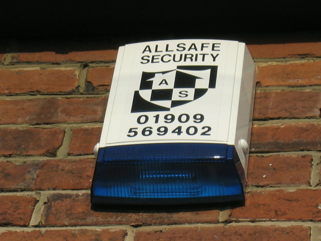

Guest aechlin Posted December 17, 2004 Share Posted December 17, 2004 Hello guys Father-in-law wants me to wire in an extra PIR to the spare/last available zone on his panel. His siren I think has a hold off facility, looks like its got a Flashguard module inside (from looking at it from the ground 20 foot away). Would anyone correct me if Im wrong, been a couple of years since I installed one, you ground the strobe wire 3 times to enter the sounder into hold off mode? It then stays like that for 15 minutes to gain access to its battery? I want to go down this route to avoid unwanted noise, because I will have to pull the panel from the wall to poke the zone cable down into the panel..Would anyone know the make and model of the housing so I could find some instructions about it? Best Regards to you all at this festive oppotunity for the previous help Alistair Echlin Link to comment https://www.thesecurityinstaller.co.uk/community/topic/4582-siren-housing/ Share on other sites More sharing options...
antinode Posted December 17, 2004 Share Posted December 17, 2004 That's a Texecom Odyssey 1. You activate the strobe three times, which puts it into engineer hold-off mode. I'm not sure how long this lasts, but I do remember that the LED's flash twice as fast if it is in hold-off mode. It might be a better idea to connect the hold off terminals to the panel back up battery while you remove the panel, as I think the hold-off mode only stops the siren sounding on bell tamper, so you can change the bell box battery etc. It may activate when you completely remove the hold off supply to the bell, regardless of the engineer hold off mode. You can get a manual from Texecom. Trade Member Link to comment https://www.thesecurityinstaller.co.uk/community/topic/4582-siren-housing/#findComment-34821 Share on other sites More sharing options...
Guest Posted December 17, 2004 Share Posted December 17, 2004 I think the Texecom eng. hold off is 15 minutes. I've got a spare set of battery leads with a length of alarm cable attached for doing this, you can put the battery on the floor then out of the way when changing panels etc... without having to put the siren into eng. mode Link to comment https://www.thesecurityinstaller.co.uk/community/topic/4582-siren-housing/#findComment-34828 Share on other sites More sharing options...

Guest aechlin Posted December 18, 2004 Share Posted December 18, 2004 Many thanks for the advice. Im on the edge of caution really, adding the extra zone is easy, only need to slacken the panel about half an inch and program the zone in, but obviously what I dont want is the siren going off and being a nuisance. So then, all I will do is remove the trigger wire to the bell, ground the strobe 3 times and basicly lengthen the battery cables. Is that the kind of way you Pro's would look at it? one again Alistair Link to comment https://www.thesecurityinstaller.co.uk/community/topic/4582-siren-housing/#findComment-34881 Share on other sites More sharing options...
Guest aechlin Posted December 18, 2004 Share Posted December 18, 2004 Just one more question, what action would I need to take to bring the bell out of eng hold off? Like to download a manual from the Gardtec website, but Im not trade....bugger. Yuletide Falicitations to you all Alistair Link to comment https://www.thesecurityinstaller.co.uk/community/topic/4582-siren-housing/#findComment-34882 Share on other sites More sharing options...
