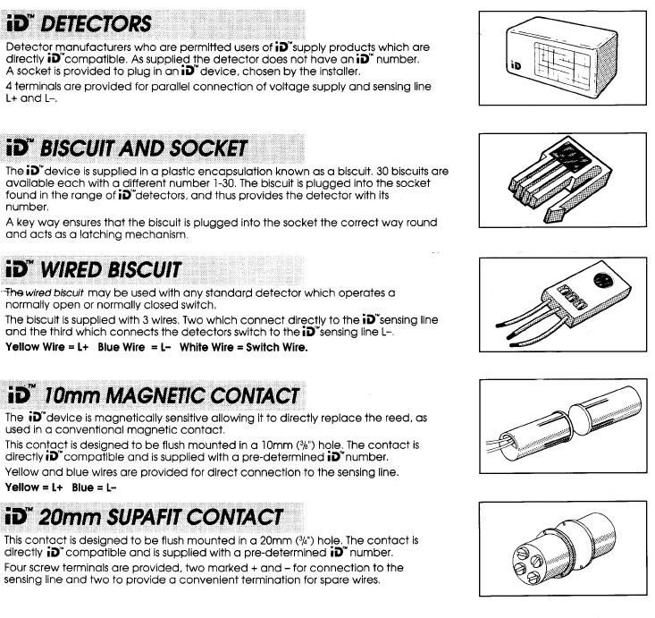

Guest Posted July 30, 2006 Share Posted July 30, 2006 amongst others, just i always feel had they sent out the pcb socket with wires on it, would be smaller and easier to instal in a 20mm door contact or surface plastic cased reed. and the envelope would not keep popping open as later versions of the older chip do no I'm on about the plug in biscuit optex did an ex35 with a socket on it. of course you could buy contactsfiited with biscuits Link to comment https://www.thesecurityinstaller.co.uk/community/topic/4505-id-id-biscuits/page/3/#findComment-108902 Share on other sites More sharing options...
arfur mo Posted July 30, 2006 Share Posted July 30, 2006 no I'm on about the plug in biscuit optex did an ex35 with a socket on it. of course you could buy contactsfiited with biscuits yeah! i know m8, it was the plug-in socket used in that Optex i was on about. the numbered contacts have the same issue with 'missing' numbers in your stock and now we have two types to deal with, againn you buy them in 10's although 10 were issued in the box early days. i don't use that many door contacts, so 1st job front door No1, Back door No2, control cupboard door No3,, next job 3, 4 & 5 etc. just gets on my tit's and never liked that skinny bar type contact for fitting either, always needed an ugly j/b. the 20mm gets damaged removing it due to the green wood swelling, and your stuffed again. regs alan. If you think education is difficult, try being stupid!!!! Link to comment https://www.thesecurityinstaller.co.uk/community/topic/4505-id-id-biscuits/page/3/#findComment-108907 Share on other sites More sharing options...
Guest Posted July 30, 2006 Share Posted July 30, 2006 just gets on my tit's and never liked that skinny bar type contact for fitting either, always needed an ugly j/b. the 20mm gets damaged removing it due to the green wood swelling, and your stuffed again. righty'o then what you need is the chunky surface contact (jb type) and the 25mm stainless capped one fitting wired biscuits to these is much easier Link to comment https://www.thesecurityinstaller.co.uk/community/topic/4505-id-id-biscuits/page/3/#findComment-108908 Share on other sites More sharing options...
arfur mo Posted July 31, 2006 Share Posted July 31, 2006 ordinary qick fits are fine, just need a deep hole to allow for the biscuit. did you know (andn i bet you did) that you don't actually need a contact with id chips, the chip will work with hall effect. place magnet in front of the chip and it changes state - now not many people know that! regs alan If you think education is difficult, try being stupid!!!! Link to comment https://www.thesecurityinstaller.co.uk/community/topic/4505-id-id-biscuits/page/3/#findComment-108960 Share on other sites More sharing options...
Anusoflannigan Posted July 31, 2006 Share Posted July 31, 2006 I cant see how as the id chip simply reports its presence on the system and wether its white and blue leg are in contact with each other via a relay or reed switch... but I shall test this out tomorrow Link to comment https://www.thesecurityinstaller.co.uk/community/topic/4505-id-id-biscuits/page/3/#findComment-108979 Share on other sites More sharing options...
arfur mo Posted July 31, 2006 Share Posted July 31, 2006 I cant see how as the id chip simply reports its presence on the system and wether its white and blue leg are in contact with each other via a relay or reed switch... but I shall test this out tomorrow theirs a pint riding on it with the original chips (not sure about the plus one's), leave the white dissed - and make that 2 pints or a bottle of scotch if you insist regs alan If you think education is difficult, try being stupid!!!! Link to comment https://www.thesecurityinstaller.co.uk/community/topic/4505-id-id-biscuits/page/3/#findComment-109017 Share on other sites More sharing options...
