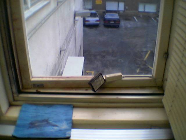

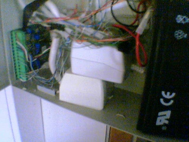

Guest Posted October 2, 2004 Share Posted October 2, 2004 Local alarm service has left the building... Mains comes to panel casing UNEARTHED But this is funny. Installer had put 2 PIRs and 1 MW in to one zone . PIR's were quite okay installed but MW like this !! Looking out the window. Propably because there are ladders next to window. This had caused ofcourse tons of FA's so installer as clever man had programed zone to NULL . It must have been very bright light in his head because that zone of three detectors were in the room where they had a safe full of money . Once and again this was one of those "quick visit"s, when you expect to be there for 15 minutes and find out that it took a day or two. Link to comment https://www.thesecurityinstaller.co.uk/community/topic/3774-mains-in-panel-casing/ Share on other sites More sharing options...
