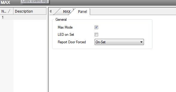

9651 Posted April 20, 2013 Share Posted April 20, 2013 probably (we turn it off) but as you weren't aware that it could, did anyone else? ;-) see attached off RSS G2 account, Link to comment https://www.thesecurityinstaller.co.uk/community/topic/34384-max-3-readers/page/2/#findComment-314715 Share on other sites More sharing options...
matthew.brough Posted April 20, 2013 Share Posted April 20, 2013 That the g2 downloader software? Of so its not document anywhere in the protocol document for max readers. Just seen you say yes RSS. Ill look into that put of interest. The status of the system can't be shown from outside. ATS has something called screensaver which illuminates the led but turns it off after 30 seconds to comply with the rules. www.securitywarehouse.co.uk/catalog/ Link to comment https://www.thesecurityinstaller.co.uk/community/topic/34384-max-3-readers/page/2/#findComment-314716 Share on other sites More sharing options...
9651 Posted April 20, 2013 Share Posted April 20, 2013 ...................Hense we turn it off, but if left default (its in command 60 max........63 something rings a bell) it does follow set unset state, all LEDS off when set, red LED shown whilst unset. Something like the ATS system would be good............ say present the fob, it briefly shows set status to the user Link to comment https://www.thesecurityinstaller.co.uk/community/topic/34384-max-3-readers/page/2/#findComment-314721 Share on other sites More sharing options...
