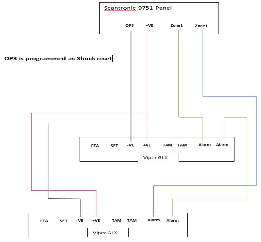

bsbsys Posted January 25, 2012 Share Posted January 25, 2012 Hi Everyone, Please can you help I have 2-3 Viper GLX's on one Zone connected to Scan 9751 Panel, Due to constraints with using existing wiring and plaster they are wired with 4 core. Please see the diagram i have attached to explain the best i can, i have wired the alarm in series and -ve terminal is connected to the OP3 at the panel as Shock reset going by the manual. I have been told this its possible to wire in this way. Problem i am getting is that when i arm the system it states the Zone is open (only with the shocks) it arms successfully however and if I bang them twice they do correctly set the alarm off Any ideas on improvements or any links i have missed out? Many Thanks B Link to comment https://www.thesecurityinstaller.co.uk/community/topic/32522-viper-glx-problem-scantronic-9751-panel/ Share on other sites More sharing options...
9651 Posted January 25, 2012 Share Posted January 25, 2012 Its because the op toggles to clear any latch everytime its set, longs its sets its OK. How old is the panel? You could have used inertia sensors as 9751 have shock analysers on ccts 1-4 off memory. You could have put the two on separate circuits. Not a fan on doors though as when the postie knocks...... Link to comment https://www.thesecurityinstaller.co.uk/community/topic/32522-viper-glx-problem-scantronic-9751-panel/#findComment-280250 Share on other sites More sharing options...
bsbsys Posted January 27, 2012 Author Share Posted January 27, 2012 Its a week old, i have actually put it on a door but not on the front one! Link to comment https://www.thesecurityinstaller.co.uk/community/topic/32522-viper-glx-problem-scantronic-9751-panel/#findComment-280284 Share on other sites More sharing options...
