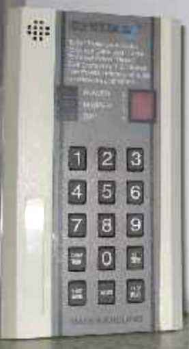

NeilT Posted April 27, 2009 Share Posted April 27, 2009 8 zone Optima XL - remote keypad in DAY mode - internal sounder going off and showing A on LED display - POWER and DAY LEDS remain lit. Entering User Code appears to solve problem, but has happened twice more since. Checked both User Manual and Installers manual and no reference to what A means on the RKP. First thoughts were that it might be a tamper issue (such as the aged bell box) but the TAMPER light isn't lit... Any advice appreciated. Link to comment https://www.thesecurityinstaller.co.uk/community/topic/28364-optima-xl-error-code-a/ Share on other sites More sharing options...
FASTCAR Posted April 27, 2009 Share Posted April 27, 2009 Are you sure of that model number?..XL didnt have RKP. A is normally Panic Attack button, check it out if you have one on the system. Link to comment https://www.thesecurityinstaller.co.uk/community/topic/28364-optima-xl-error-code-a/#findComment-235216 Share on other sites More sharing options...
NeilT Posted April 27, 2009 Author Share Posted April 27, 2009 Thanks...I'm sure it's an XL, but it code be an XM. Deffo 8 zones - steel enclosure for the main panel, with x2 RKPs. There are PA's attached so will check them over. Link to comment https://www.thesecurityinstaller.co.uk/community/topic/28364-optima-xl-error-code-a/#findComment-235219 Share on other sites More sharing options...
stevie Posted April 27, 2009 Share Posted April 27, 2009 it can`t be a XL or XM. both of these don`t take keypads and they don`t have 8 zones . nor to they have a steel enclosure for the main box . as fastcar says check your panic buttons , as A usually is a panic button on some systems. Link to comment https://www.thesecurityinstaller.co.uk/community/topic/28364-optima-xl-error-code-a/#findComment-235270 Share on other sites More sharing options...
hpotter Posted April 27, 2009 Share Posted April 27, 2009 Optima 2plus? Link to comment https://www.thesecurityinstaller.co.uk/community/topic/28364-optima-xl-error-code-a/#findComment-235271 Share on other sites More sharing options...
lawandorder Posted April 27, 2009 Share Posted April 27, 2009 Optima 2plus? Sounds like it to me, are the keypads portrait or landscape (well I can't think of a better way to ask)! Link to comment https://www.thesecurityinstaller.co.uk/community/topic/28364-optima-xl-error-code-a/#findComment-235297 Share on other sites More sharing options...
FASTCAR Posted April 27, 2009 Share Posted April 27, 2009 Agreed..2plus Link to comment https://www.thesecurityinstaller.co.uk/community/topic/28364-optima-xl-error-code-a/#findComment-235326 Share on other sites More sharing options...
NeilT Posted April 27, 2009 Author Share Posted April 27, 2009 That's the one...RKP's are "portrait"...crikey...it was about 15 years ago when I installed it! Ok, will check the PA's as I know it has x2. everyone. Link to comment https://www.thesecurityinstaller.co.uk/community/topic/28364-optima-xl-error-code-a/#findComment-235329 Share on other sites More sharing options...
