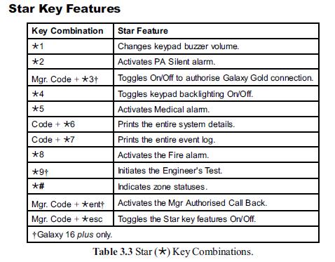

james.wilson Posted April 23, 2009 Share Posted April 23, 2009 its not an option on the 16+ as there is no keypad menu. Only programmable on the bigger galaxys However you can lower the volume securitywarehouse Security Supplies from Security Warehouse Trade Members please contact us for your TSI vetted trade discount. Link to comment https://www.thesecurityinstaller.co.uk/community/topic/28313-galaxt-16-bleep/#findComment-234656 Share on other sites More sharing options...
rs-485-bus-driver Posted April 23, 2009 Author Share Posted April 23, 2009 he wants it off not low. how would you lower it? Link to comment https://www.thesecurityinstaller.co.uk/community/topic/28313-galaxt-16-bleep/#findComment-234687 Share on other sites More sharing options...

james.wilson Posted April 23, 2009 Share Posted April 23, 2009 see attached securitywarehouse Security Supplies from Security Warehouse Trade Members please contact us for your TSI vetted trade discount. Link to comment https://www.thesecurityinstaller.co.uk/community/topic/28313-galaxt-16-bleep/#findComment-234693 Share on other sites More sharing options...
rs-485-bus-driver Posted April 24, 2009 Author Share Posted April 24, 2009 thanks turned it down then blutack still a little sound but he's happy Link to comment https://www.thesecurityinstaller.co.uk/community/topic/28313-galaxt-16-bleep/#findComment-234815 Share on other sites More sharing options...
StevieV Posted April 28, 2009 Share Posted April 28, 2009 thanks turned it down then blutack still a little sound but he's happy Press *1 (simultaneously) and this will toggle through the different volume settings on a 16+ if this doesn't work, try code + *esc (simul) and then *1. Just seen redbull's post after posting mine....sorry.....teach me for not logging in ! Link to comment https://www.thesecurityinstaller.co.uk/community/topic/28313-galaxt-16-bleep/#findComment-235421 Share on other sites More sharing options...
