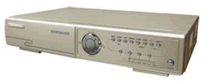

paddy Posted October 4, 2008 Share Posted October 4, 2008 Hi Hope someone might be able to help me identify the make of a DVR which a customer has asked me to connect to the internet for remote viewing. Original installer no longer in business and I can find no Software installation Disks The unit is marketed on a number of on-line sites as DVR760 (4 channel TRIPLEX unit) for example http://www.henrys.co.uk/cctv/dvr.htm#760 Any help in identifying the unit, or where to get a copy of the Remote View software would be really appreciated. Thanks in advance Paddy Link to comment https://www.thesecurityinstaller.co.uk/community/topic/24979-help-identifying-dvr/ Share on other sites More sharing options...
alterEGO Posted October 4, 2008 Share Posted October 4, 2008 this might be the software http://www.securicorp.com/cctv-downloads/dvr-ap.exe Link to comment https://www.thesecurityinstaller.co.uk/community/topic/24979-help-identifying-dvr/#findComment-212467 Share on other sites More sharing options...
Doktor Jon Posted October 4, 2008 Share Posted October 4, 2008 Looks like this one ... http://www.avtech.com.tw/image/product_pic/sheet/AVC760.pdf Link to comment https://www.thesecurityinstaller.co.uk/community/topic/24979-help-identifying-dvr/#findComment-212526 Share on other sites More sharing options...
scorpion Posted October 5, 2008 Share Posted October 5, 2008 Doktor John has the right link! The AVTech AVC 760, CPCam 560, and the Nubix 4BC is a model 3. This is the only one that cannot be backed up with USB, it has to be backed up by the remote software. Model 3 does not have the USB feature. Models 1,2, 4, and 5 do This uses the ap called Video Server E. There are many versions of Video Server E, and any one of them will work. ____________________________________________________________ ____________________________________________________________ I also want to give a shout out to Kensplace!! How are you doing??? Link to comment https://www.thesecurityinstaller.co.uk/community/topic/24979-help-identifying-dvr/#findComment-212591 Share on other sites More sharing options...
paddy Posted November 5, 2008 Author Share Posted November 5, 2008 Hi Guys Thanks for your help, you were right on the money. Now I have figured out the DVR and the software Any ideas on the default user name and password for this mode. The user name is being populated with "admin" Thanks again Paddy Link to comment https://www.thesecurityinstaller.co.uk/community/topic/24979-help-identifying-dvr/#findComment-215655 Share on other sites More sharing options...
jackbuchan Posted November 5, 2008 Share Posted November 5, 2008 Hi GuysThanks for your help, you were right on the money. Now I have figured out the DVR and the software Any ideas on the default user name and password for this mode. The user name is being populated with "admin" Thanks again Paddy yes video server E username: admin Pa55word also : admin Kind Regards, Jack Buchan JDB Solutions Web: www.jdbsolutions.co.uk E-Mail: jack@jdbsolutions.co.uk Link to comment https://www.thesecurityinstaller.co.uk/community/topic/24979-help-identifying-dvr/#findComment-215683 Share on other sites More sharing options...
