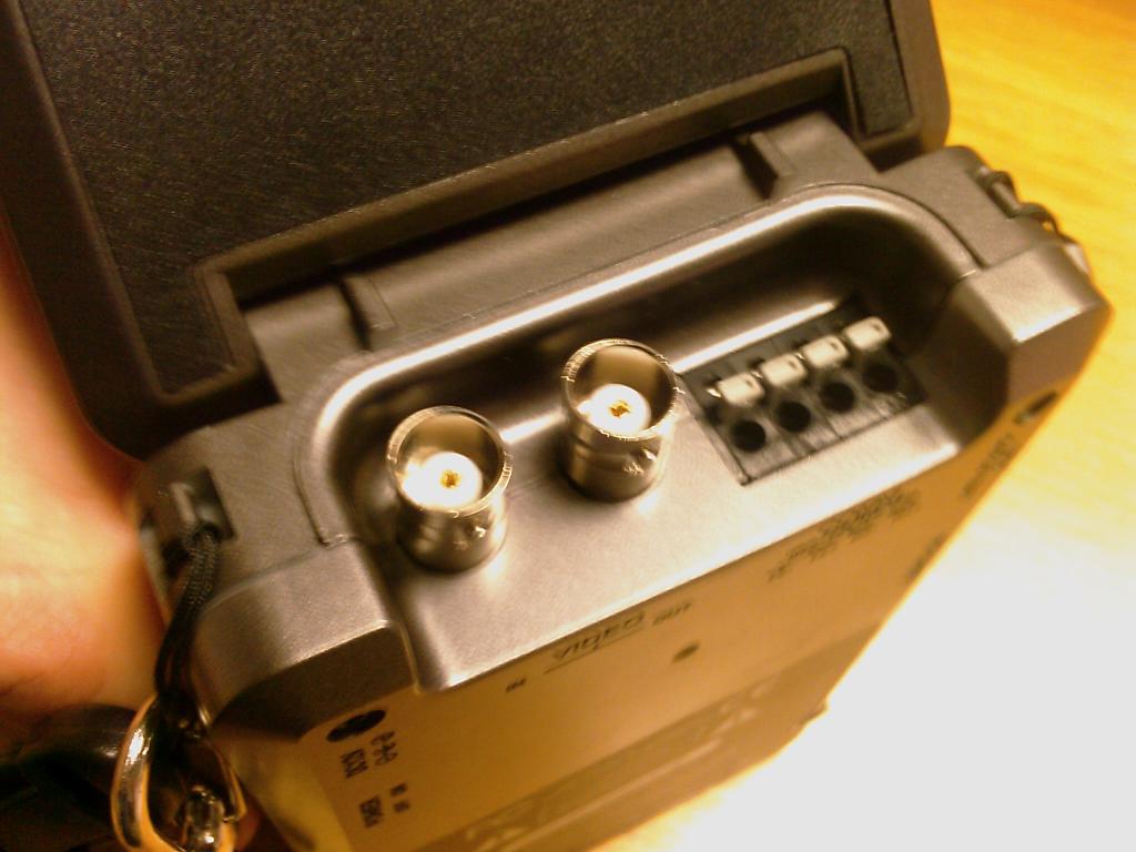

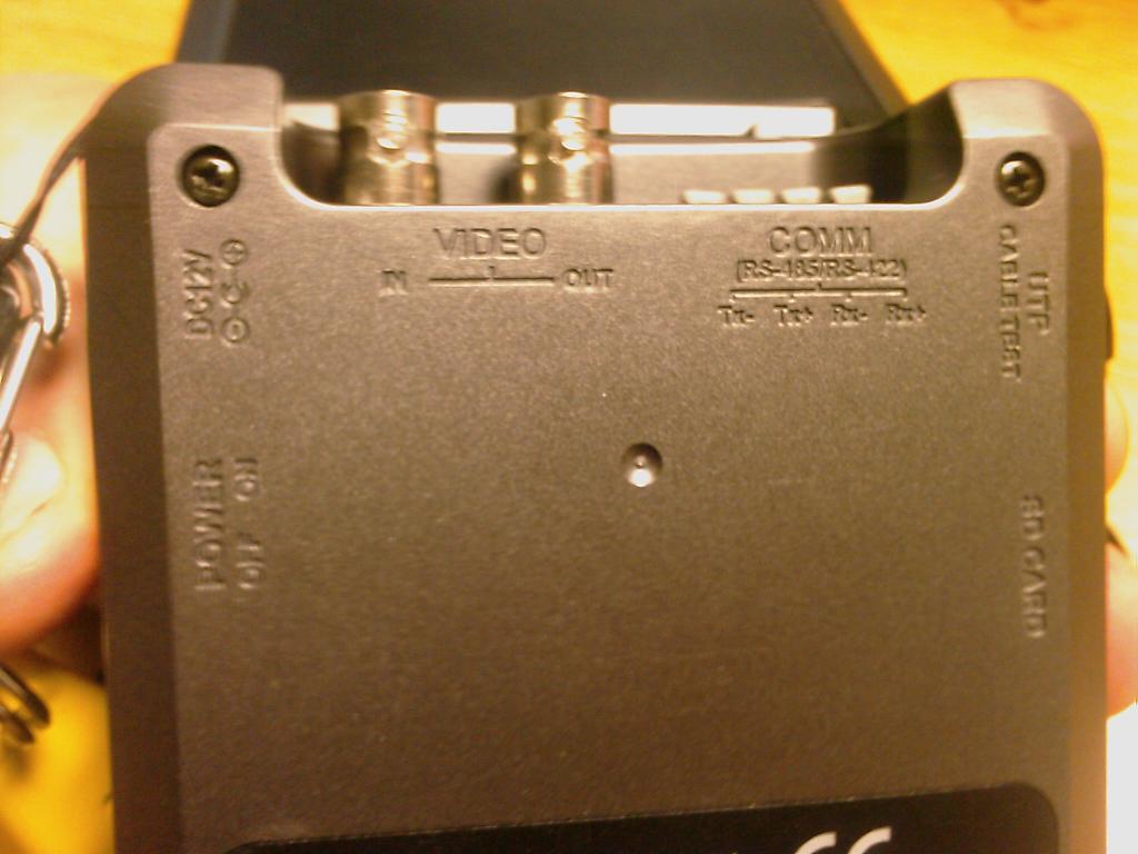

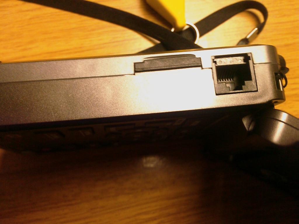

The plastic of the Rapport 2 Feels suitably solid, and the hinge mechanism feels suprisingly and reasuringly smooth. The device has no rubber protection and IMO would not survive even a small drop, obviously the hinge would be the weakpoint. There is a lanyard included to allow hands free operation (if you have a stomach to balance it on!) There is also a yellow CAT 5 attachment that resembles a Balun. Included in the box is also a manual, unfused test leads for the multimeter function, and a uk plugged brick type charger. As this outputs 12v DC Id assume most engineers will add a cigarette adapter to allow in the field charging. A cigarette charging lead would have been a welcome addition. I must say the unit does look the part and looks like the specialist professional bit of kit its supposed to be, unlike some test monitors which resemble in-car dvd screens from argos. The connections around the unit include, 2 x BNC for video in and out, 4 x spring loaded terminals for RS 485/422 data, A charger dc in socket, and a cat 5 8P8C socket. The unit arrives well packaged in a 230mm x240x 100mm box, with foam cutouts for all accessories. Strangly the carry case listed on the genie website is not included.

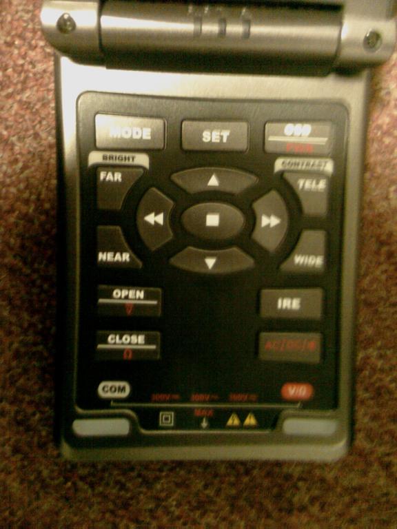

Using the mode button selects all the functions in a cycle, and holding it allows access to other menus such as system config, sleep time etc. Using the Rapport 2 in its main mode (Field monitor) provides a blue sceen on no video or the current connected video. It appears the device auto detects PAL and NTSC but defaults to NTSC on no input. I have no NTSC cameras to test this, but connecting a PAL source immediatly changed the display to PAL. Pressing the IRE button gives a breakdown of the Sync and Video Voltage which will be helpful when setting up the amplifier. In use i found the screen OK but it did not have the detail or resoltion of the Computar CRT test monitor to enable pin sharp focusing. Cameras with a lens wizard that open the iris fully for back focus adjustment would be easy to setup, but other cameras requiring a filter kit wouldnt be so easy IMO. The picture was more than acceptable for an LCD though. Pressing 'SET' in this mode makes the unit output some colour test charts. These are the std colour bars, Green screen, Blue screen and red screen and will be again very useful when setting up amplifiers or active baluns.

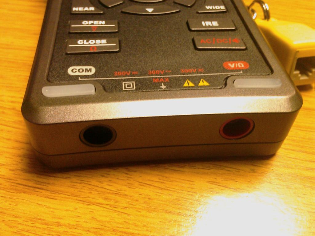

The Multimeter option allows, DV Voltage, AC Voltage, Resistance, and continuity. All modes are autoranging and provide a graphic progress bar and the actual reading.

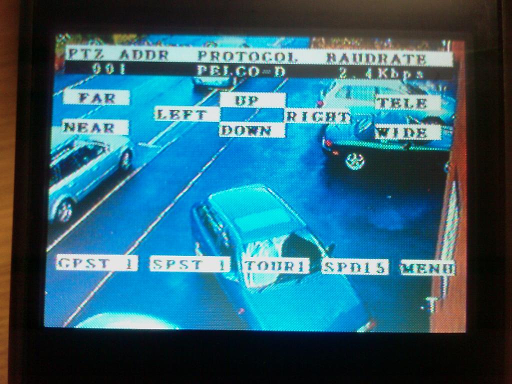

The PTZ Controller mode allows you to select required PTZ address, Protocol and Baudrate and PTZ speed. PTZ features available include, Focus Far & Near, Zoom Tele & Wide, Up down left and righ, Goto preset x, Store preset x, Goto tour x and Dome Menu access.
Available Protocols in the review unit are:-
VCLTP, VC2500, Pelco-D, Pelco-P, KTL-ASC, KTL-DIGI, Yujin-PD, WONWOO, WV-CS850, Fastrak, SPD-2500, SCC-643, Supremacy, AD RS422, SJ-100, SJ-1000, DYC, DY-SP360D, DY-255RXC, ORX-1000, VICON, LG Multi. On speaking to Genie it is unknown if the unit can be flash upgraded to support additional protocols. They are currently looking at adding BBV protocol. As we use Dennaed domes we have no support for these. Also Up the coax telemetry is not supported.
This feature is probably the units second most useful feature and performs very well. There are 2 leds under the screen marked as TX and RX and show the current status of the 485 data line.
The UTP mode is used with made of CAT5 leads with 8P8C connectors. Connecting one end into the unit and using the yellow rubberised dongle, this test shows if all 8 connection are correct and not crossed over or open circuit. It is not a full UTP tester ie detecting range to short etc.
