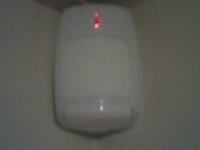

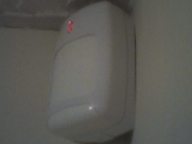

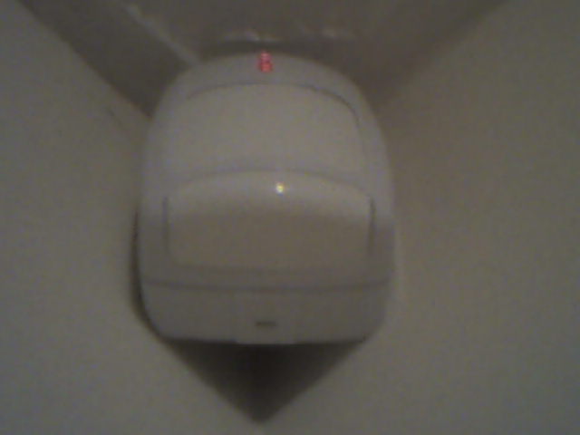

Hiya
Here are some photos of one of the sensors.
Thanks
Sue

As RJB says, C+K with creep zones directly below, not pet friendly.
