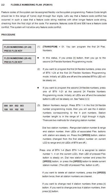

Guest projectfocus Posted September 19, 2006 Share Posted September 19, 2006 I'm not an expert but none in my country knows about this switch. I bought it from morocco, they don't support it anymore. Here are the programming steps you need. Link to comment https://www.thesecurityinstaller.co.uk/community/topic/12570-help-lg-gdk-162/#findComment-120840 Share on other sites More sharing options...
Guest MaliPBX Posted September 19, 2006 Share Posted September 19, 2006 Hey Guys, I appreciate your help, the flex numbering plan worked for me. As i had the old stations assignement plan i was able to bring it back to the right nums. Thank u. Link to comment https://www.thesecurityinstaller.co.uk/community/topic/12570-help-lg-gdk-162/#findComment-120894 Share on other sites More sharing options...
