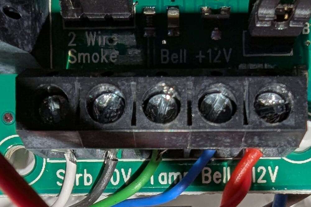

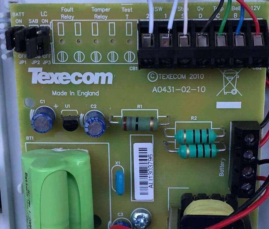

  3. Comfort LED's are normal, alternating between the left and right LED's inside the box. On the keypad, if I go to Engineer Utils > Bell Test > On, the bell correctly sounds. Same for strobe when I test. This is the strange thing. The wiring must check out as the bell works when testing from the keypad respectively?
  4. The bell doesn't go off if I open the panel cover Bell doesn't go off if tamper is removed at panel Bell DOES go off if I open the bell box cover Strobe only flashes on alarm being activated/triggered
  5. Same problem. Regardless of how the alarm is triggered (either entry timer expiring or just immediately walking in front of a PIR that is set to Guard) the bell doesn't sound but the internal keypad and strobe goes off...
  6. I haven't programmed anything to change the defaults, is it set to these by default? Will take a look.
