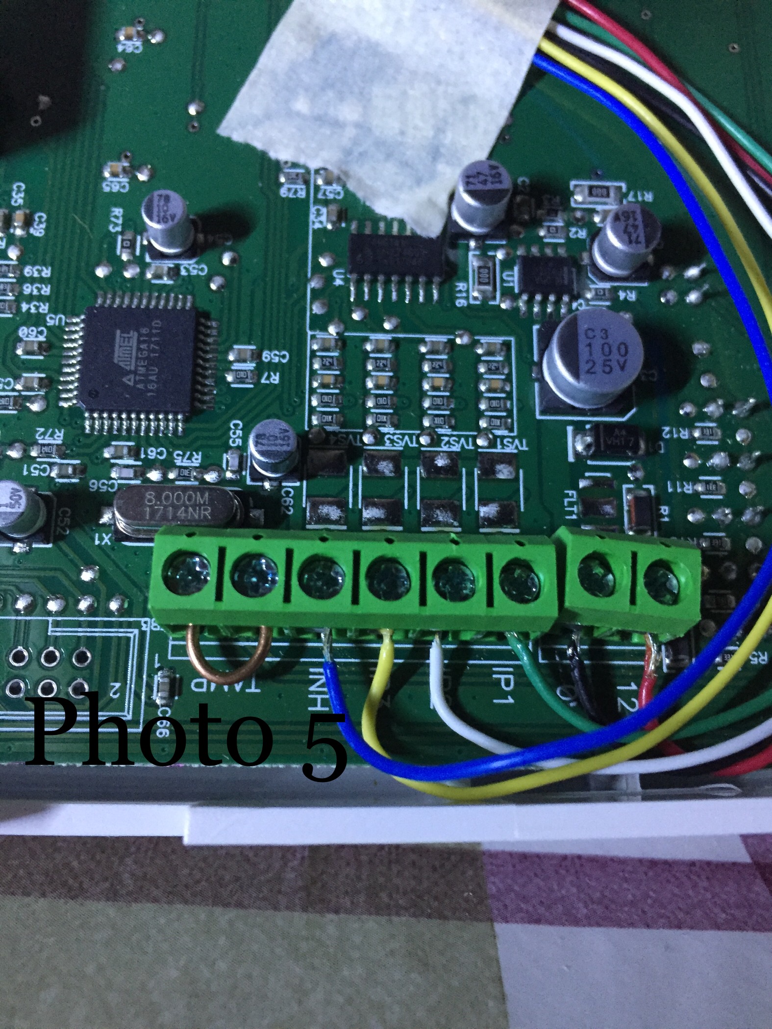

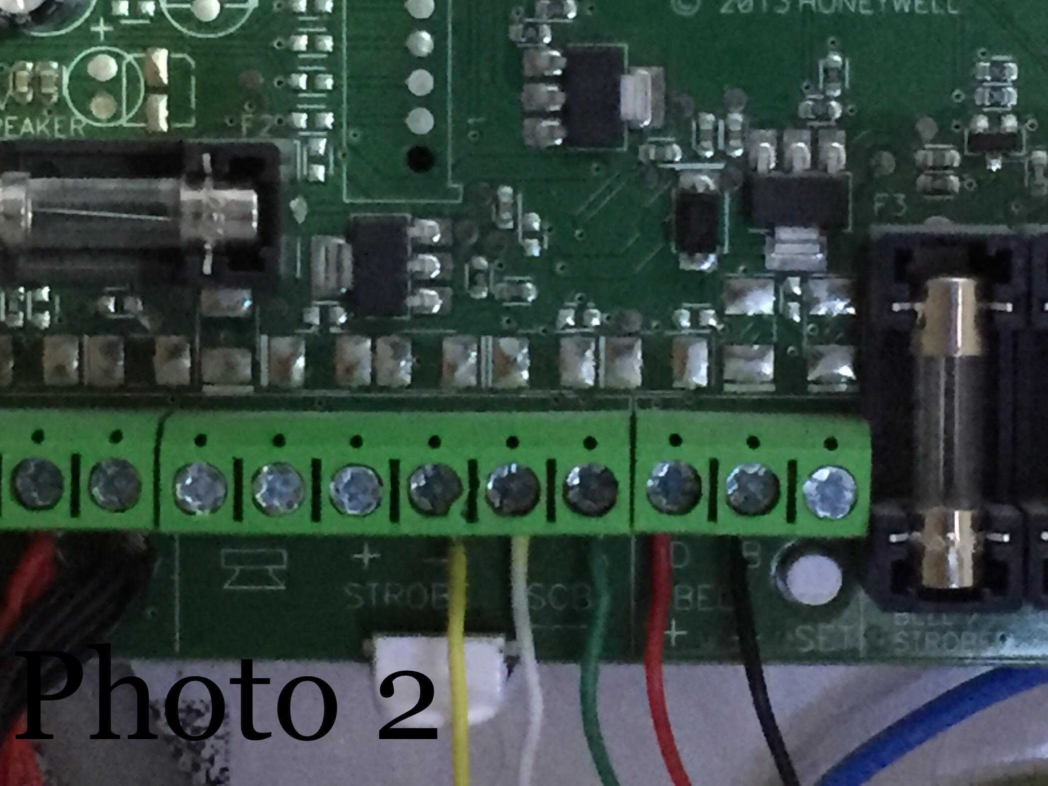

  3. I have now numbered the photos of the wiring, I hope this helps to understand what I have done. Photo 1, overall view of the Accenta G4 panel Photo 2, Outside box connection on panel Photo 3, connection to outside box Photo 4, connection of speech dialler on panel Photo 5, connection to speech dialler Photo 6 wiring diagram for outside box as shown in Accents manual Photo 7 wiring diagram for speech dialler as shown in speech dialler manual Photo 8 connection of keypad on panel Photo 9 connection to key panel
  4. I have just looked at what i have sent and it looks like they have not been sent in the sam order that i loaded them. will try and sort them out.
  5. I have taken some photos of the wiring, I hope this helps to understand what I have done. Photo 1, overall view of the Accenta G4 panel Photo 2, Outside box connection on panel Photo 3, connection to outside box Photo 4, connection of speech dialler on panel Photo 5, connection to speech dialler Photo 6 wiring diagram for outside box as shown in Accents manual Photo 7 wiring diagram for speech dialler as shown in speech dialler manual Photo 8 connection of keypad on panel Photo 9 connection to key panel

  7. I changed the four inputs triggers on the speech dialler from active low (LED on) to active high(LED of). All that happened was that the speech dialler instantly went in to the dialling sequence.
  8. I am not sure about thees triggers. I had noticed the comments on the previous posts reference inverting the triggers but i can't find any reference to this in the manuals.
