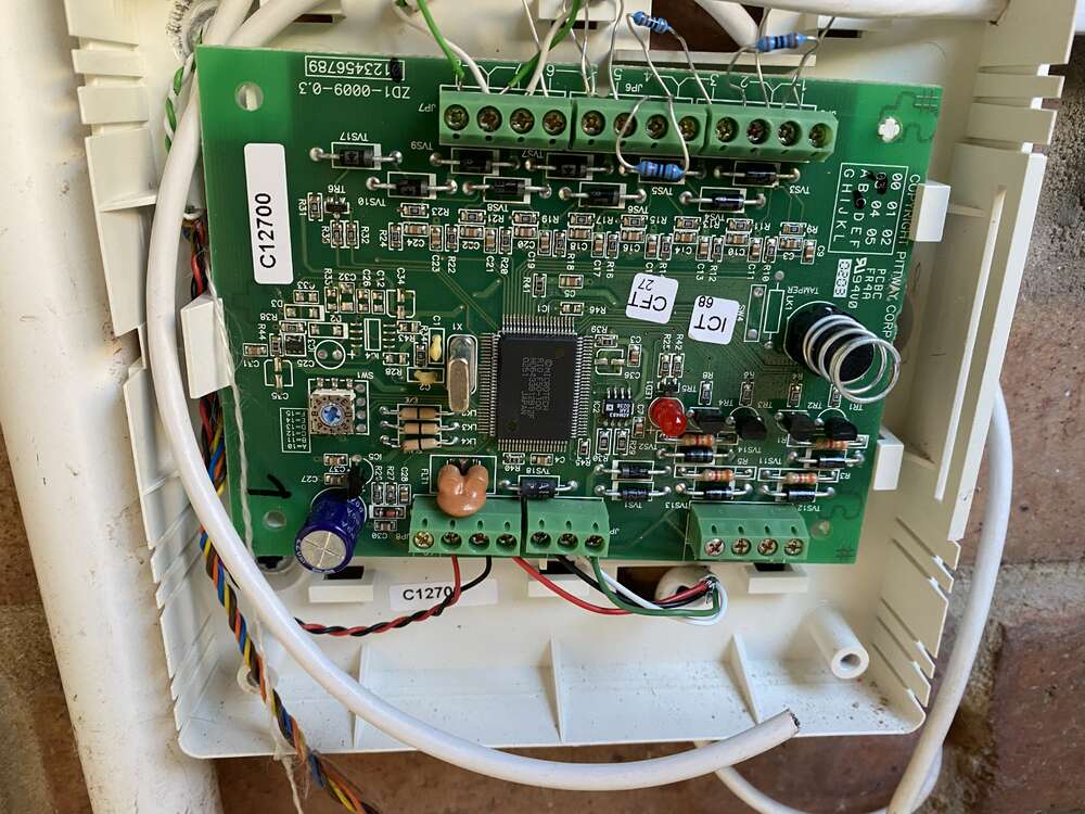

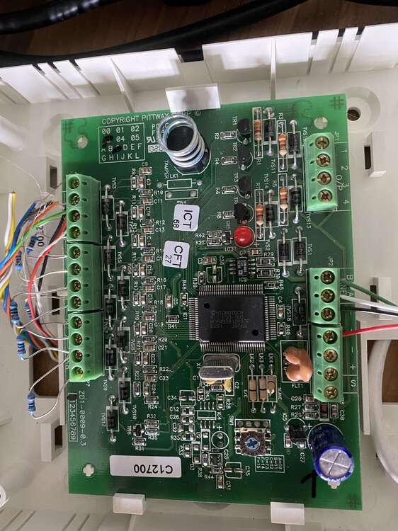

Ok will try that. I think starting afresh is a good idea. I did originally have the unused zones locked out via option 18 “Spare”. The manual does state that it is recommended that a 1k resistor is connected across the zones, is this so on a Rio? All though it does look like the zone 1-2 legs are touching they are not, it’s just the angle the photo was taken at. Once I have got it working I intend to tidy everything up. Thanks
Galaxy 48 Rio, zones not working
I have just realised that I have uploaded the wrong photo, the correct one is now attached (Joys of posting in the early hours while waiting for meds to kick in). The Rio is set to 5 and not 3 as previously stated. Zone 6 is not connected yet in the photo. The zones are 1051 to 1058 i have reconnected link 4 and still the same. The panel is a Galaxy 48. Thanks
Link 4 remade and still the same ?
Sorry, not worded very clearly. The resistors are at the 2 contacts and the PIR, only the unused zones have them at the Rio
By the sound of it I am doing it in error. I followed another post I found online. I have only cut one side so I can easily reattach it it. Hopefully you lot can tell me the correct way to do it. There are only 1k resistors in the unused zone terminals, plus 2x1k on the other 3 zones Thanks, Keith
Hi all, following a few garage break-ins on our estate lately, I decided to change to a Rio from a single zone so I can add a PIR. Everything went ok, the system detects the Rio, Rio set to slave via link 4, but I can only get one zone to work.All are set to intruder. zone 8 Roller shutter contact - works normally zone 7, PIR - Nothing zone 6, Door contact, Nothing I did have the Door Contact working on zone 2 at one time when I tested it before installing. It is set to address 3 I have searched online for guides on installing nd programming, but can find very little. Photo is from when I tested it. Thanks for reading, Keith
