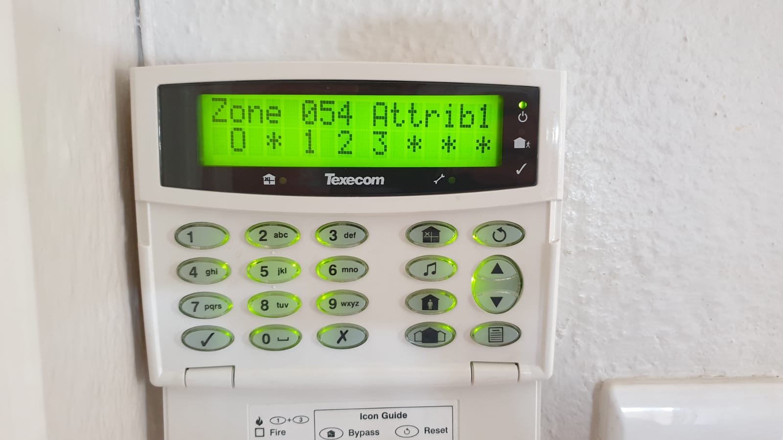

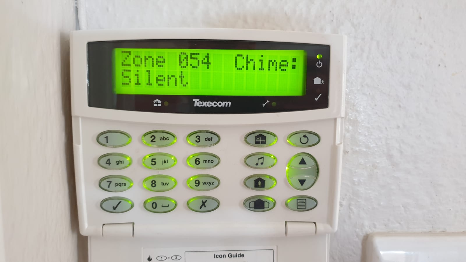

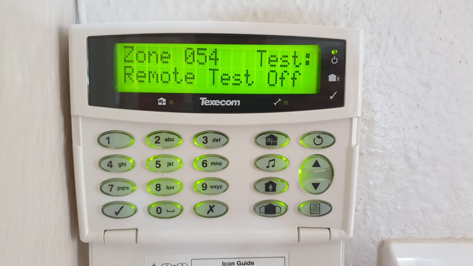

  13. Hello. First time poster here. I'm getting annoyed with installers never doing exactly what I want, so trying to learn to do this myself. I have a new QD-W indoor ricochet PIR. I followed this video to add it: https://www.youtube.com/watch?v=vMFKPf77VVM It seems to have gone well as I have been able to see the following: - A tamper alarm for the zone when I was busy installing the PIR - When doing a walk test for area 1 the zone is picked up when I walk through it. Due to the location of this zone it is omitted from all part arms and should only be armed when I do a full arm on area 1. I tried setting my alarm now and walking into the room, but my alarm is not triggered. Other than the omit zones, all the other settings appear to be exactly the same as another one of my zones. Attached are screenshots of the zone setup, what am I missing to get this zone to trigger my alarm when fully armed:
