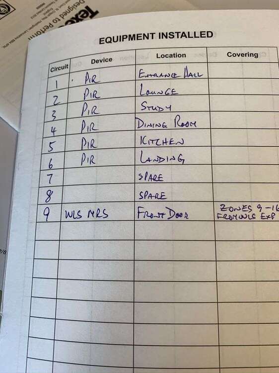

  2. Thank you to all of you for your interest and replies. Just checked the details of the alarm and software: it's an "Elite 24" and the software version is V3.01.02.LS1. It is always the same fault that occurs, and the fault message always relates to "Zone A". The external alarm never goes off, it's just the internal one that emits an alarm and then requires that I reset the system to clear the fault. It is a wireless door contact that is fitted and this was replaced on the last engineers visit. In addition, I am connected to the BT "Redcare" monitoring service and the alarm faults that I have experienced have never triggered any alarms at the Redcare centre. I attach a photo of the "Equipment Installed" page of my Information Handbook. Grateful for any further advice that will help me steer the engineer in the right direction.
  3. Just to add to the above, I think I have interpreted the note. In the installation instructions, against Zone 9, the Device is shown as "WLS MRS Front Door", Location is "Front Door" and then I think the comment mUst be "ZONES 9-16 FROM WLS EXP". However, there are no active Zones other than Zones 1-9
  4. It's sporadic and infrequent. Last week, there were 3 occasions on separate days, whilst on those same days it also armed properly. According to my installation instructions Zone 10 is not enabled. There is a hard to read note in the instructions that look like "ZONES 9-16 FROM UNLS EXP"
