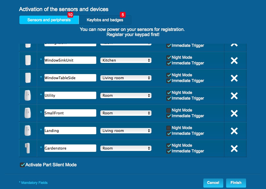

  1. Hi, thanks for the quick replies. Currently had it on the floor and set up as if on a wall. Rear tamper pressed (as if on a wall), inserted batteries in order, then depressed and gel front tamper. Makes beeps for a while. Released front tamper but no change. While testing the bell box is in a different room than the Le Sucre main box. On the tag reader, there is a line that connects Full arm/Partial arm with a picture of a bell, is this related and what does it do? Looked through all the manuals and no mention of it. Also , on the register page there is a tick box "activate part silent mode' but no explanation. see screenshot thanks
