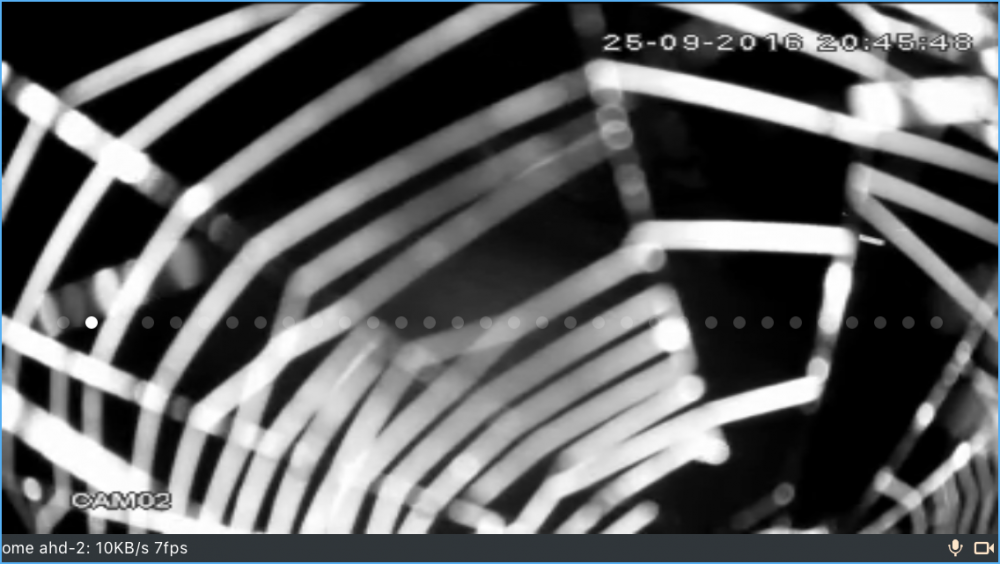

  4. Spiders would defo cause this and I've used spiderex for a number of years now. It work better inside on pirs but not that good on infrared cameras. This is 3 weeks haha!

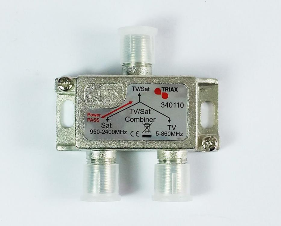

  6. Thanks but I don't get it? aeriel and hd signal in the outputs and feed to TVs in the input?

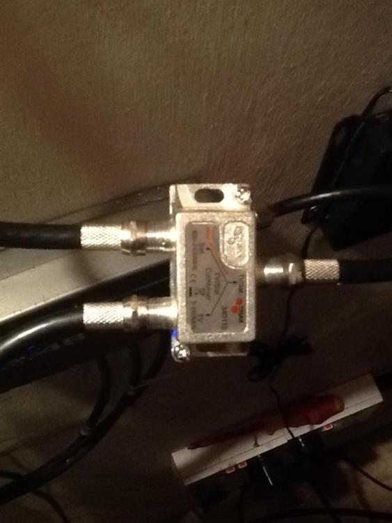

  7. Ok sounds good. its all up and running ok now but I prefer to do the job right so could you link to what I need please? appoligies for picture but was off iPad as phone had died. thanks to all who helped

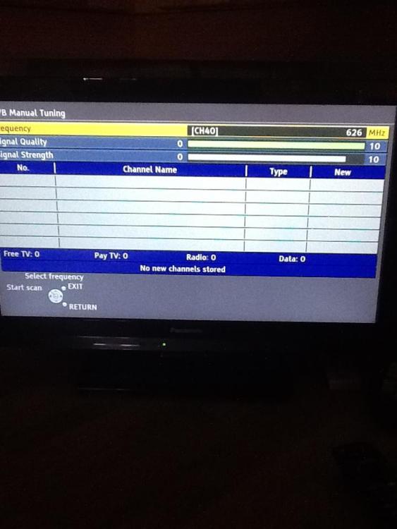

  10. Yes dvb tv yes technomate T-M-rf hd now set to Lcn 800(which first time I've altered) channel 40:626.0mhz programme number 60 tried manual search no new channels
  11. One thing tho. Most of channels are on 27 bbc itv etc. If I set modulator to 27 and prog number to say 40 it disrupts the normal channel arrangement when tuned. Not sure if that proves anything other than the tv is getting something from modulator?

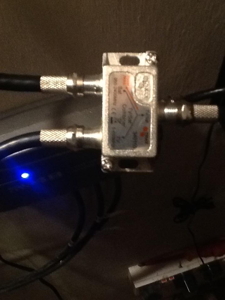

  12. No I've stripped it back down and can't generate Cctv picture at all. hdmi gets a picture when plugged directly into a monitor then I plug into modulator. I've tried Rf out directly to TV cutting out attenuator and combiner - no Cctv. Tried Rf out no attenuator into combiner - no cctv.Tried loads of different channels configs. As set up now I get TVs ok on all TVs. Tried using Rf loop through on modulator - nothing at all! Although internet says loop through is when stacking modulators. Unfortunately I can't get hold of spectrum analyser for few weeks but as I had Cctv up once thought there must be a way. Tried altering attenuator every half turn then re tuning.tried different TVs.
  13. Hi all, im struggling with this hd modulator. im trying to get hdmi out of Dvr onto all TVs. could someone tell me if this is wired correctly.the horizontal coax to combiner is the aerial. The attenuator is 20db ive had Cctv up once but no channels now can't get it again. what channel would you recommend? Between 21-69 then what programme number? The user instructions for this technomate are pants any help appreciated
