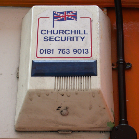

  3. Looks interesting, I think I have seen them before Look like this? Did it still work when you took it down?
