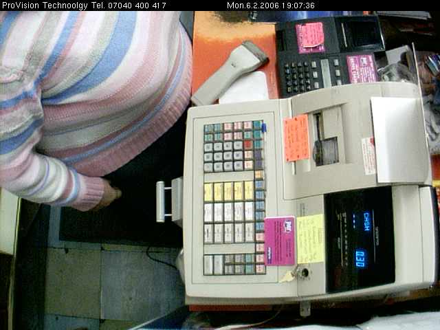

Guest Robmanchester Posted February 6, 2006 Share Posted February 6, 2006 Hey Guys thanks for the all the information. I think the top and botom is that for some reason in the UK we get poor upload speeds (any one knows why let me know?) unless we pay mega bucks. The axis 206 camera was set up with the following: 640x480 Resolution Medium compression 5 frames per second Unfortunately the system was set up for a local shop keeper who wanted to view what was happening in his shop while he wasn Link to comment https://www.thesecurityinstaller.co.uk/community/topic/9215-axis-206-network-camera/page/2/#findComment-85914 Share on other sites More sharing options...
