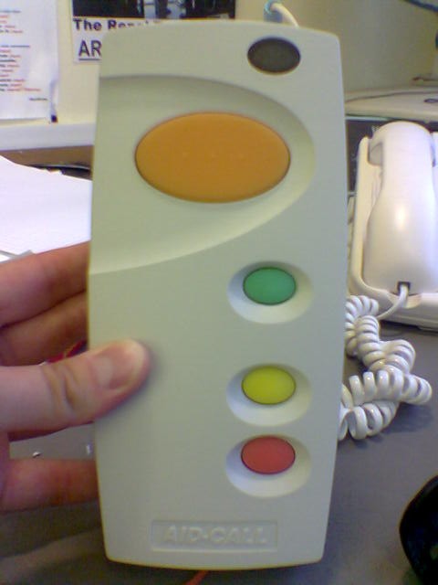

Wooly-bobs Posted September 21, 2005 Share Posted September 21, 2005 Having a bit of a problem programming a new hand set, followed the instructions but it isn't communicating with the main receiver. Anyone had a go with one of these systems??? Link to comment https://www.thesecurityinstaller.co.uk/community/topic/7486-nurse-call/ Share on other sites More sharing options...

Wooly-bobs Posted September 22, 2005 Author Share Posted September 22, 2005 Not too sure about this site code business. Tried programming the handset to the appropriate missing code (202) but it isn't receiving. The system is about 15 months old. This is one of the new handets, they are all the same.. Link to comment https://www.thesecurityinstaller.co.uk/community/topic/7486-nurse-call/#findComment-69128 Share on other sites More sharing options...

Stealth Posted September 22, 2005 Share Posted September 22, 2005 That is an ATX2000, will work on the CP3000 control panel, you need to have the house code for the system so you can add it to the system, PM me and i will send you some info. Or you can find some info here Don't double address the unit, see what the other units are set to then add your new unit to the system. Chubb Service Engineer Link to comment https://www.thesecurityinstaller.co.uk/community/topic/7486-nurse-call/#findComment-69204 Share on other sites More sharing options...
